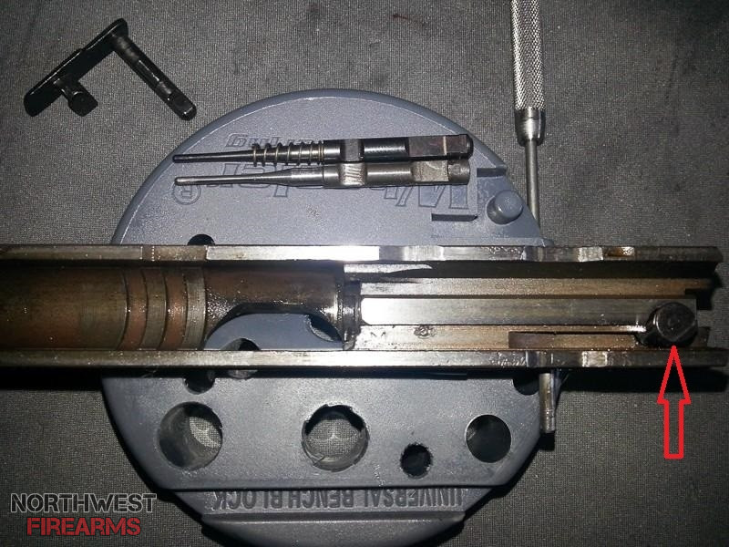

The cz 75 b action is drop safe the pre b action without the firing pin block as found in some of the competition cz pistols is not drop safe with the hammer down.

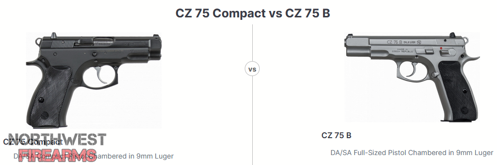

According to HandgunHero I don't have the 75b.
The important bit is whether or not your slide has the firing pin block like in this picture. If your slide has the roll pin through it in the serrations like the one on HandgunHero it should have the block. CZ makes a lot of models that have the block even though they don't have a "B" in the name. That being said, the half cock position still seems like the better option to me. If you're manually decocking the gun it should be much harder to ND if you're only going to half cock instead of fully decocking. It also effectively lessens the required trigger finger reach as you noted.
Mine does appear to have the block. I note that mine sits recessed whereas yours seems to sit proud. It appears the reason for that is that you've removed the firing pin.
I'll likely carry "half-cocked" as I prefer to err on the side of caution and it seems to be a reasonable balance. For now, I need more time with the gun to learn the trigger and proper handling habits before I start carrying it.
