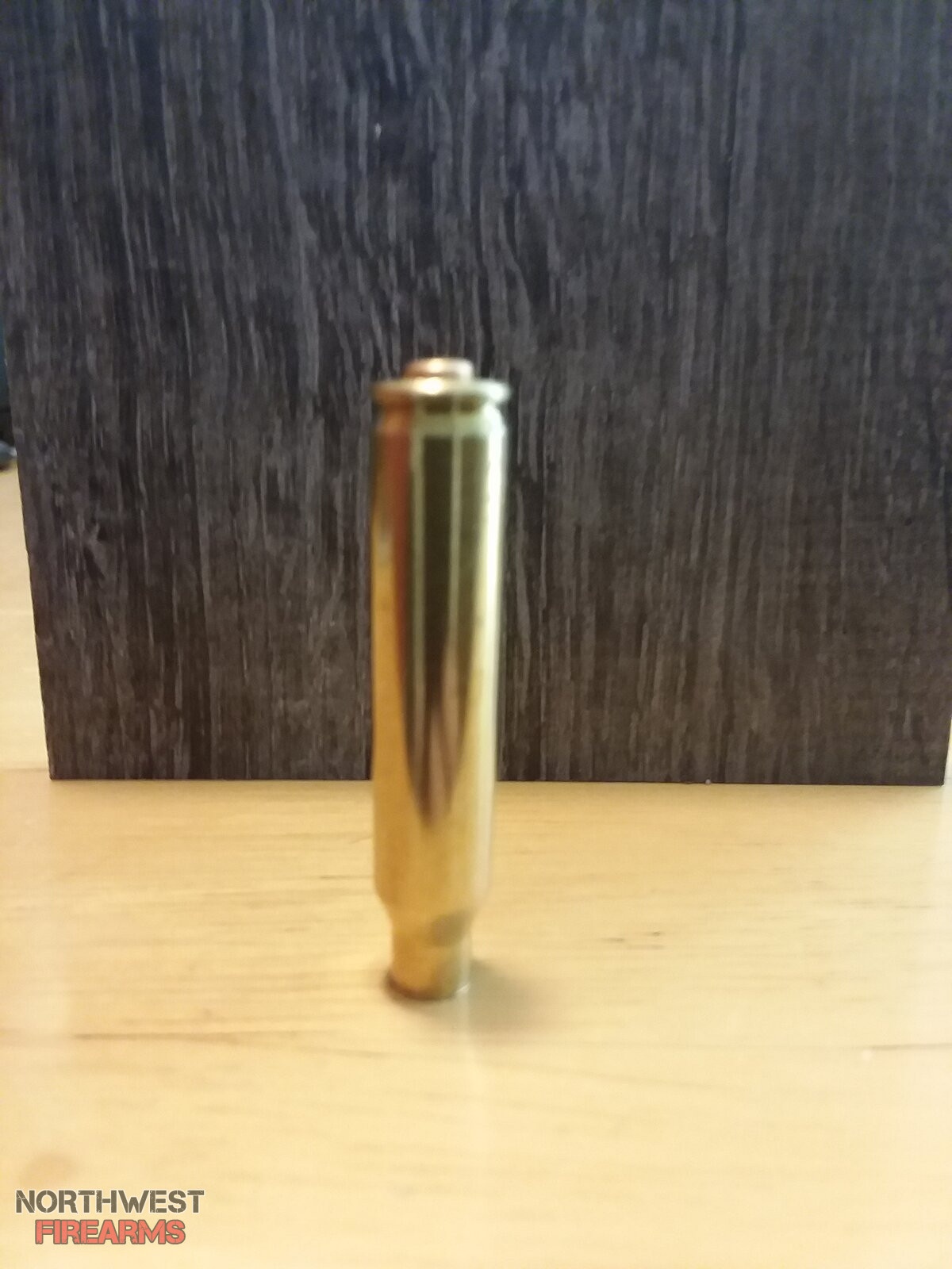

Your idea inspired this. I drilled out the small primer pocket to loosely accept a #11 cap. I left the hole shallow enough that the cap is sitting very proud. If I can get the bcg into battery without setting off the cap. It may go off when firing pin smacks it. I will slowly send the bcg into battery. I don't want to try it here in the condo but I will find a safe space to try it this week, stay tuned. It will be loose though so some pressure, flame, gases, fouling, etc are going to leak through the primer hole when firing an actual load.
If this idea worked and didn't have too much blow back (I will be surprised on both counts), I would have to have the muzzle pointed at the ground in order to insert the cap. Then slowly close the bcg on the cap before elevating the rifle again.
The advantage of this method would be that I could remove the extractor from the bolt and have the case stay in place for a few shots before cleaning. Then use a cleaning rod to pop out the case when I wanted to do a more thorough cleaning.

I measured how proud the primer was and it is sitting .050 high above the case head. I suspect the #11 cap will squish down some when the bcg is put into battery. What is left sticking up should be whatever headspace there is. Hopefully the firing pin will ignite the cap instead of just pushing it further into the primer pocket.

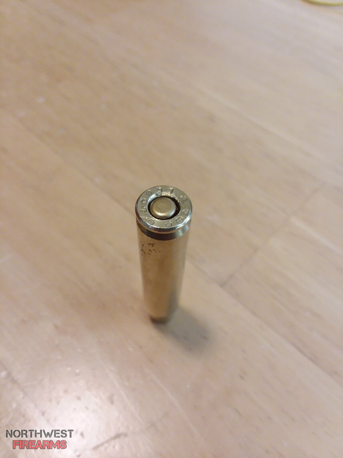

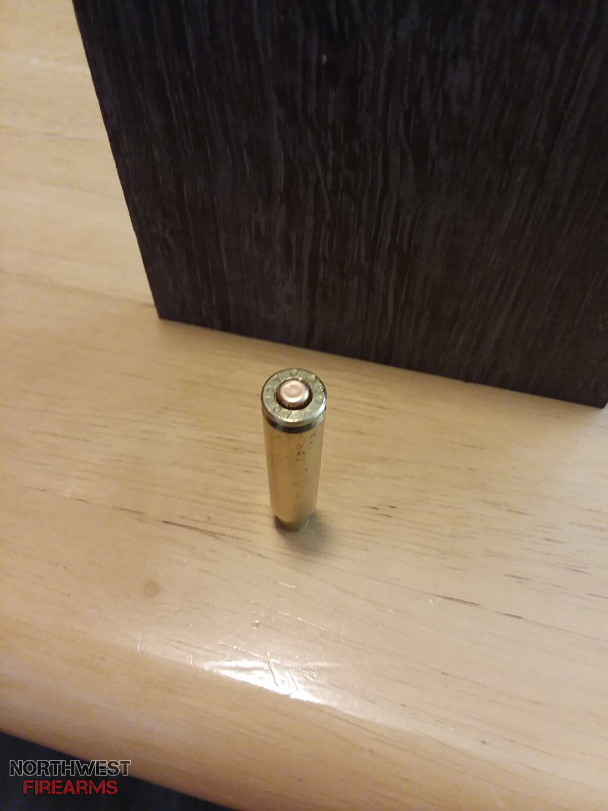

I have no idea why I was fussing with a #11 cap. It was an earlier idea I had to enlarge primer pocket and use a regular primer.
I might have went a little too deep with the primer pocket drilling as the primer is sitting below flush now but it pops in and out with ease. I will go ahead and test out both for fun but I would much rather use regular primers.
Photo below is of the same case that I drilled out for the #11 cap but with a small pistol primer inserted in it.
