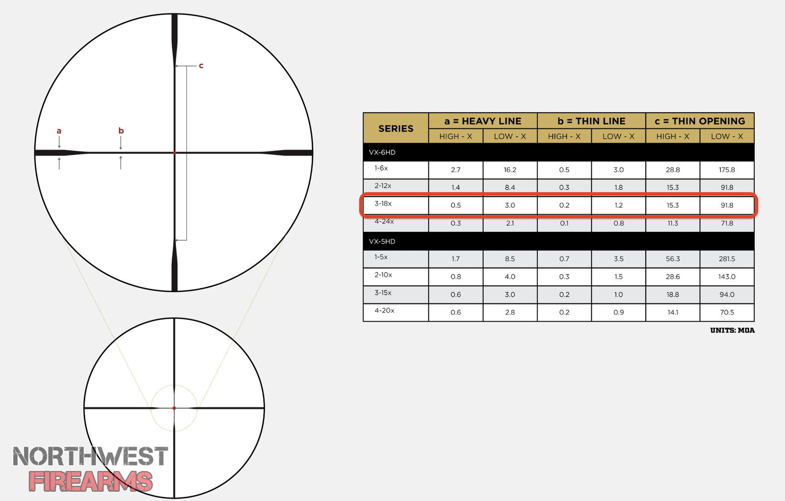

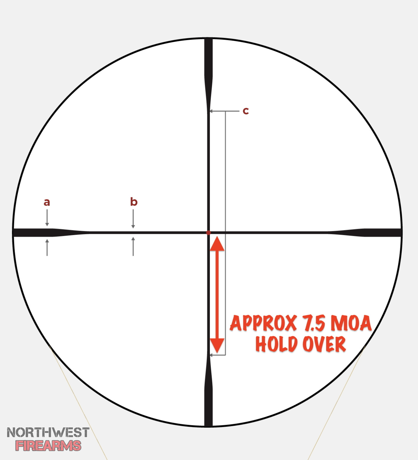

Max Magnification
Even with the limited information that the reticle provides, you can still use it to approximate a range and establish hold overs when needed.

You wouldn't have to dial in the elevation.
Max Magnification
Edit to add: You could also use a ~25/300 yard zero to reduce the elevation to ~20 MOA and limit adjustment runout @ 1000 yards.
