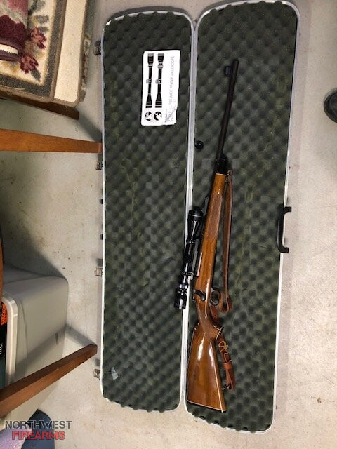

I have a relative that I am assisting who was left a Remington 700 BDL rifle in 30.06. The rifle is pristine with a cheap Tasco scope. However, someone put it in a hard case and broke off the top of the top turret when closing the case. I am not a bolt action guy and my question is what an appropriate scope might be to replace the damaged one? I would like to put on something that would do both target (range up to 300 - 500 yards) and yet also be able to hunt. Cost in the $250 - $400 range.
Would something like a Vortex Diamondback in 4x16x42 be a decent choice? Any of you have this scope?
https://www.midwayusa.com/product/2420373744?pid=373744
I also have a decision to make as to removing the existing rear sight depending on scope placement. (Note: the existing scope is right up against rear sight.)
Thanks in advance for any comments.

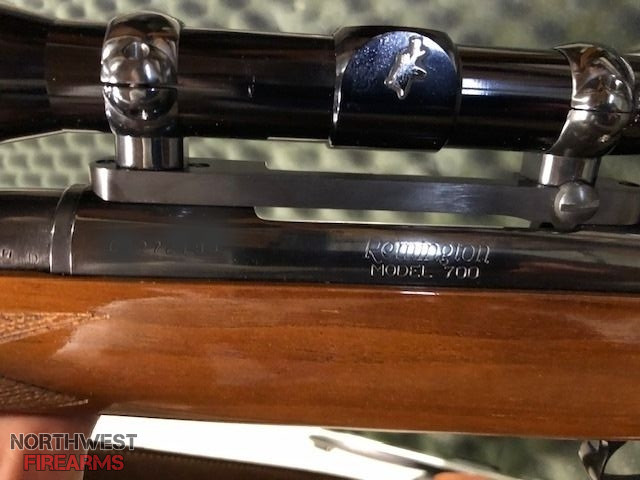

The scope is mounted on a one-piece flat bridge across the chamber area - I believe it is marked "Burris." I do not know what the rings are. I did see another old online listing that appeared to have the same rings and called them Redfield, which would seem to be appropriate for the 1976 manufacture date of the rifle.
Nothing wrong with that setup. Take a close look at the scope where the rings are mounted after removing it to see if there's any pressure points or crimping on the scope tube.
Having the rings lapped before installing a new scope might be a good idea.
I still recommend new rings and mount, but those will work but you will need to lapp those to the new scope. I would also remove all screws and check threads for rust, especially the reciever screws.

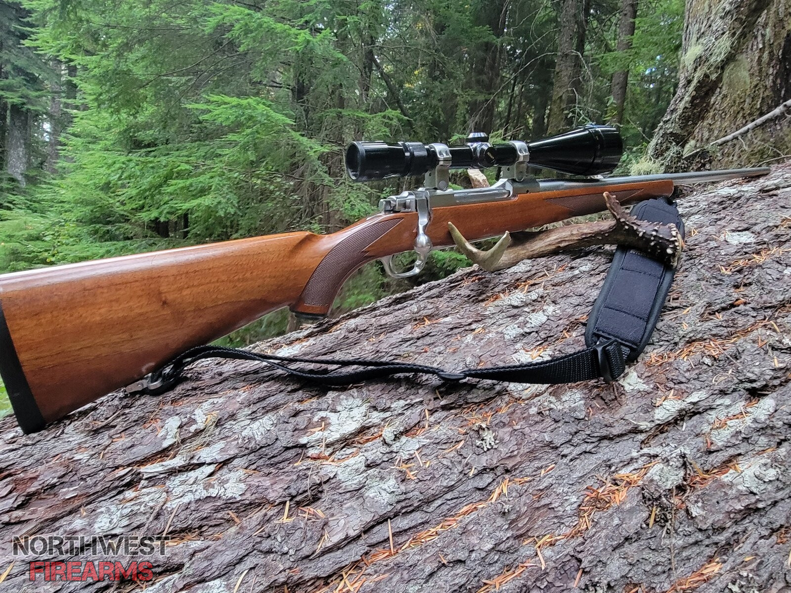

Burris Fullfield E1 4.5-14 x 42
I have two. Outstanding value for $180.
One is on my 20" 7mm-08, which kicks like a 24" 30-06. It has held zero for years, and I don't expect it to ever lose it.
Why would he replace these? Good pieces on his rifle.
