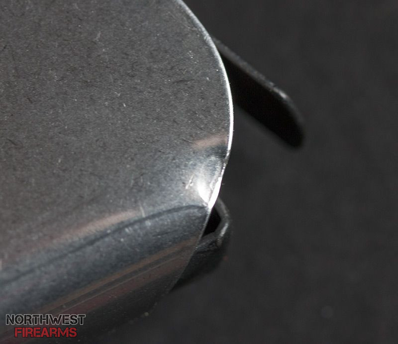

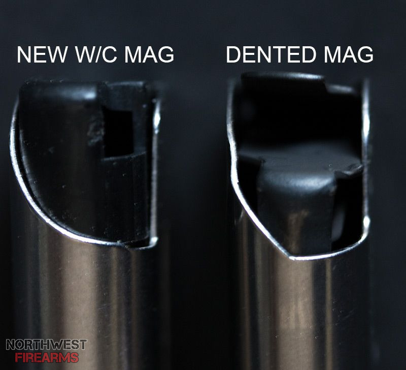

I think I discovered the problem: I'm 95% certain it's a damaged mag. At the top where the mag comes in contact with the magazine catch lock when inserted into the handle/grip, there is an obvious dent. When I push down on the spring assembly it catches slightly at that point - it's not much but it's a noticeable hitch. Because it is at the top, any affect it would have had would be on the last round. Problem identified (I think)!
The cause is (I assume) from slamming the mag into the pistol. I don't recall ever doing that myself - I usually go with a firm and steady push until I hear the click, but I was out shooting with some friends recently (before these troubles started) and one of the guys kept banging the mag into the gun (Hollywood style! He seemed fairly new to pistols, though he was otherwise behaving in a safe manner). I told him to take it easy and not bang it but to push it firmly until it clicked into place, but he kept doing it. Needless to say he didn't get to shoot my gun anymore after that. Ever since then I've had the feed issues. Took the mags out and inspected them, comparing them to my Commander mags and saw the dent. It's much more pronounced on one than the other. I hope the internal magazine catch lock isn't bent, but since it's not malfunctioning and still clicking the mags in place, I think it's fine.
I bought a couple new Wilson Combat mags. Not only are they not dented at the top, but they are slightly more curved than the standard Colt mags, which may help initiate the levering-back of the magazine catch lock without damage. Still, I'm getting in the habit of pushing the mag-release button each time I insert a mag, just until it's past that section. I haven't had a chance to test them for better performance, but I suspect I will no longer have this particular feed issue.

Certainly looks like a contact point! Good job!

the nice thing is, you can probably save that Colt Mag by gently tapping out the bend with a small ball peen hammer ( Tiny Bopper) and it should run just fine! Good luck!:)
Yep. I'm going to see if I can salvage the mag. I probably won't trust it for EDC, but it might work fine as a range/practice mag.
