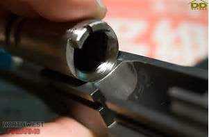

Sounds like the rounds are pushing the slide stop up.Okay, someone on another forum suggested adjusting the extractor tension. I watched a video from Wilson Combat on Why an extractor might need adjusting and how to do it. I made a slight adjustment on the extractor based on that info.

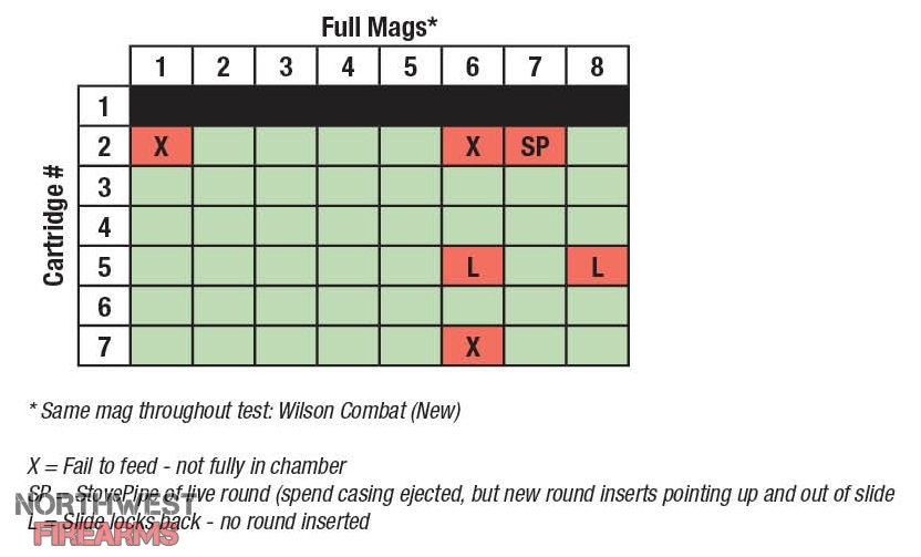

Today I went out shooting with the Missus and her dad. Since we were mainly out for fun I didn't keep track of my rounds and mag loads, but I shot about 75 rounds and had 3 FTF issues. That's a drop from 11% failure to around 4% after adjusting the extractor.
Curiously, two of the FTFs were from the slide-lock engaging when there were still rounds in the mag. Would that be extractor related, or mag-related? I'm thinking mag, but am open to alternatives.
At any rate, it's nice to be moving in the right direction. Hopefully I can make further adjustments to get it down to 1% or less failure rate.

Maybe post a pic of the feed ramp relationship.. like
hopefully the barrel isn't hanging over the frame part of the ramp.
Are your bullets getting gouged by the ramp?
