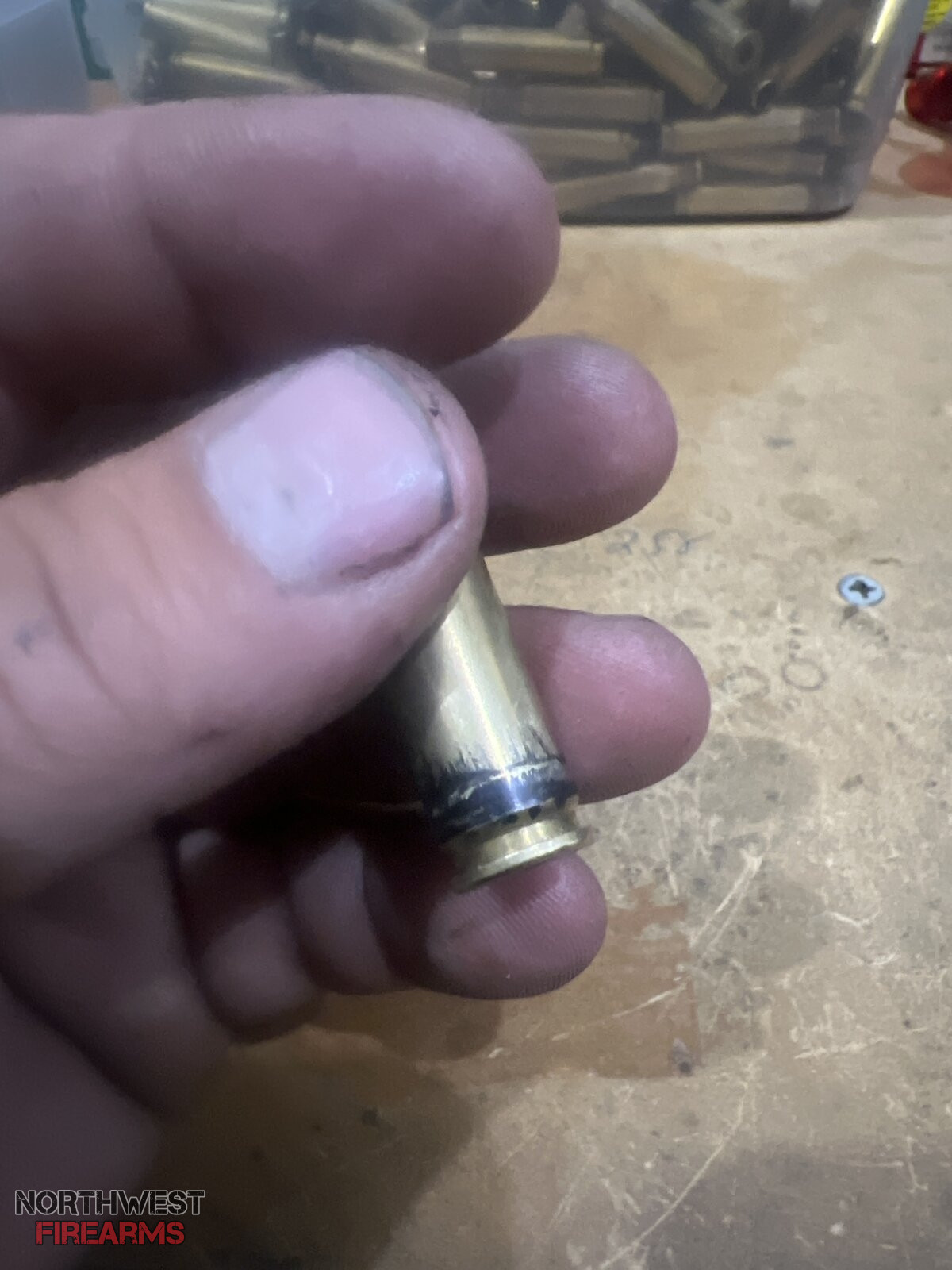

Loading for a new rifle. HS Precision pro-2000 with a 26" proof 9tw carbon 308 Winchester. Loading with Forster co-ax, RCBS sizer (no expander), 21st century .3065 mandrel, Hornady OAL gauge, and headspace comparator. LC M118LR once fired cases. All annealled prior to sizing, neck turned, and weight sorted.
To start off. Took measurements of chamber. Chamber length came in at 1.6255" on my headspace gauge. Set my FL sizer to 1.6230 (.0025 bump). Resized a bunch of cases afterwards. Loaded up rounds and found I had a few that were hard to chamber. Went back to the bench and measured a bunch of cases. I did find a few that didn't get sized all the way (<~5%). Not sure how that happened.?.?.? I tried to chamber them after resizing a second time and no improvement. Hard time getting the extractor to latch over the rim and hard bolt throw down. Bolt will come 90% of the way up then stops. Gotta put some effort in to get the last 10% of movement. Thus, ensue chaotic thoughts. Brass? Sizer? Barrel?

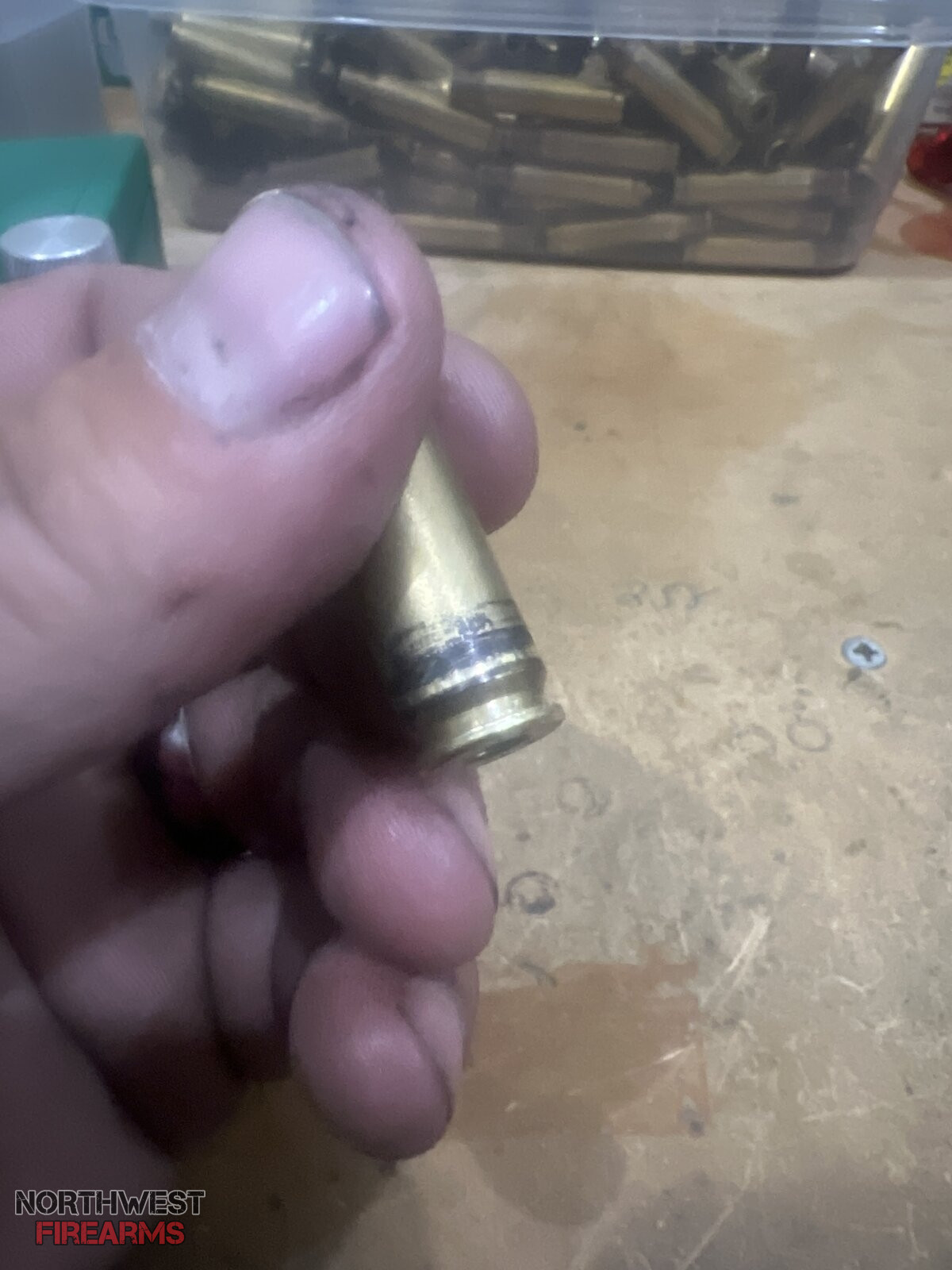

Any thoughts on the subject? I'm assuming the barrel was a blank as the chamber info was never struck. No idea of the smith either. The one thing I'm hung up on is the barrel. It's a shooter, but when cycling the same hard to chamber round in the chamber repeatedly it would develop a shiny ring at the base of the case. That ring however was not concentric around the case. It would be almost all the way down to the rebated step and the opposite side is about 1/4" away from that step. I did that test with a sharpie to highlight it. Let me know what you think?

Did you do the first firing, in this rifle, of these cases? If not, maybe they were fired in an oversized chamber and your die doesn't resize small enough on some cases.
Custom barrel: You may have a minimum or below chamber (not headspace but base diameter.)
Borrow a friends sizer die to try, just for some more information.
Maybe you need a small base die.

Yeah these are all mil-surplus. I had the same thought on being from an out of spec chamber. I also thought maybe run the small base option on those who aren't chambering. It looks like they are all tight at the base. I pulled out my mic and most were oversized compared to good ones. But there were also some that were exactly the same size and still didn't want to chamber. And lastly we don't have many good smiths around us anymore so casting the chamber will be another day lol. Thanks for all the input. I was just tired of racking my brain. I opted to just cull the brass that feels oversized.
