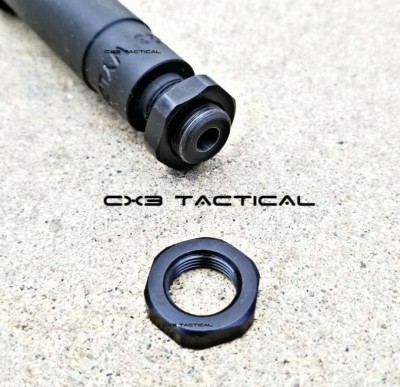

also, might wanna do some research i think some of those AAC muzzle devices seat on the crown and some of them seat on the shoulder. could be wrong but thought i remember reading something like that.
theres other options on there also.
