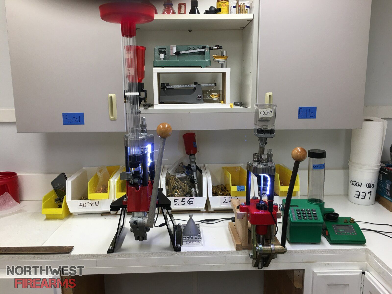

Hi Jim! Nice bench!!! (mine is messy)
For accuracy rounds, I weight out each and every rifle charge. Since I am only loading 10-20 rds at a time, it is no prob. However, if I was loading .223 for plinking, I would weigh them like I weigh my pistol rds... every so often. For me that is 10-20rds.
Thanks brother, it's getting there.:)
