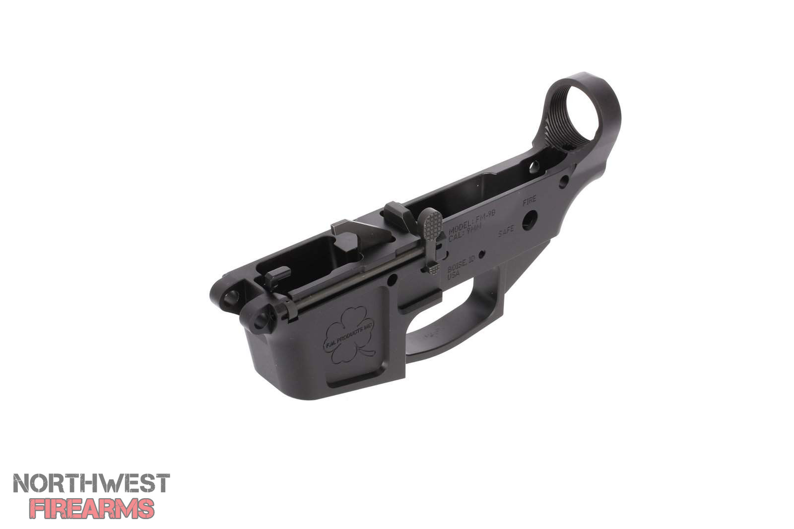

After looking around most of the last two weeks I found what looks like the better or best lower for 9mm. The Foxtrot Mike receiver. It's got what looks to me to be the best in the industry LRBHO available for AR style platforms using Glock magazines, I'd even say it's better than CMMGs design.
So far this build is in its infancy. Just got the lower, and a few parts I've collected to be put on it. The stock, buffer tube, grip and trigger. Trigger is one of my new faves, the Aim Surplus single stage. I also already have a micro red dot ready for it so I'm good on the sight as well. I picked up a Swampfox red dot during their presidents sale. It's a glorified Vortex or Burris clone, but it looks and feels decent.

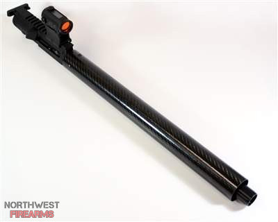

Handguard. Sort of stuck on this one. I like the idea of Kaw Valleys CF tube. Silly slim. Silly light. I may still go with a lightweight slim aluminum still too.

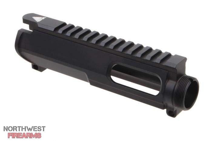

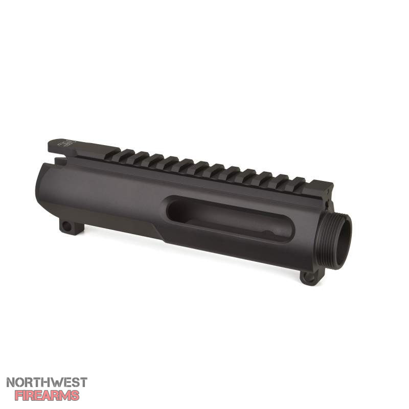

Little browsing this morning. Found Nordic Components. They have a pretty plain upper and PCC specific small diameter handguards.

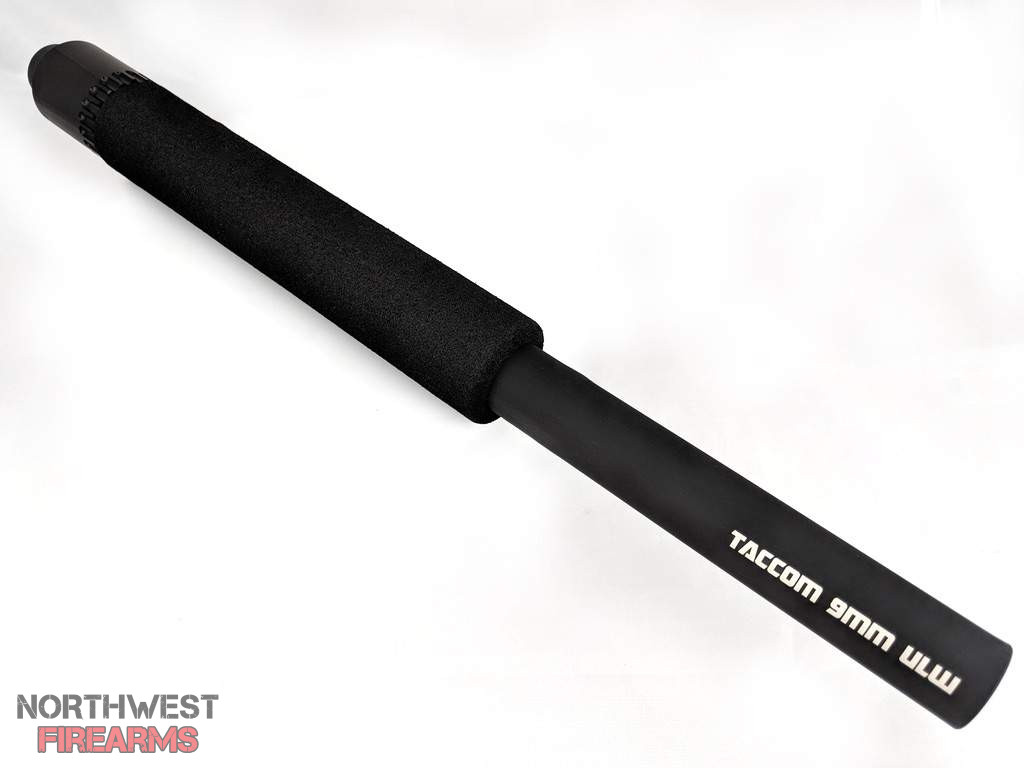

Also found a unique barrel option by Taccom. It's a 5.5" barrel with a pinned and welded 16" shroud. Meant to be as light as possible.
That looks like a rifle ejection port.
I like the other one you posted better for a pistol build.
If I were to do a 5.5" barrel, I would SBR it or do a pistol brace.
Not a giant muzzle device.
I don't think that's the point of the Taccom barrel. They specialize in competition stuff. Most USPSA match's don't allow pistol braces weapons. I'm uncertain to SBRs I think I've read somewhere some are allowed in certain divisions.

The Taccom barrel may have some advantages over a longer actual barrel. More pressure builds in 16" pistol caliber barrels. So by having a legal length, but shorter barrel, you could run a lighter buffer system and it should be less snappy overall.

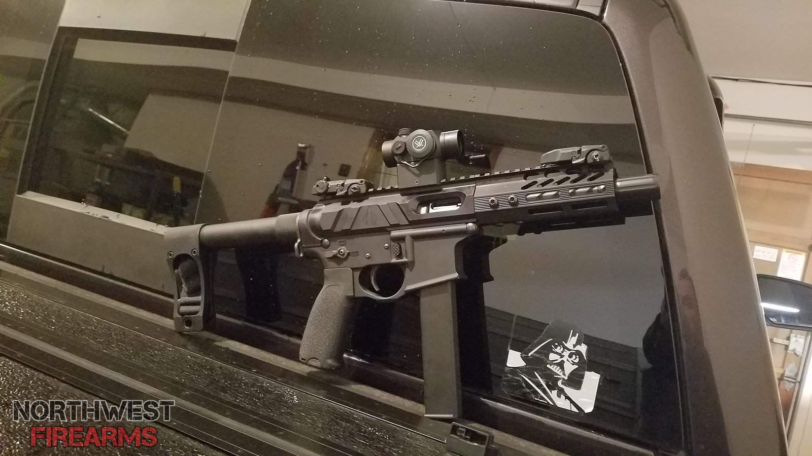

That's a nice lookin' build !
Is that a Colt pattern ?
Gibbz is supposed to be the route, for pistol side chargers.
Yes it's a Spike's Colt pattern lower. As a note to anyone who might choose to go with a Colt pattern lower...you'll have to bend the ejector slightly to get it to eject reliably. I was disappointed when I first brought it to the range. After working with one of the RSOs on it, we learned that the ejection design they use can also work for .45 which has a large casing to make contact with. To work with the 9mm, the ejector has to be bent inward slightly to effectively contact the casing and knock it out. Put about 250 rounds through it after that without a single hitch.

I contacted them about it. They said they bend it themselves for their builds but since I just bought it as a stripped lower it came straight. Fortunately it was a super simple fix
