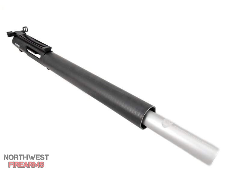

I have no experience with the adapters. I'd probably say you would be fine with one. My main thing, though not a huge deal, is they use a different magazine release that's part of the adapter. The regular mag release would taunt me all the time and I'd probably try to use it all the time forgetting that I need to hit some button under the magwell on the adapter.
I couldn't find a side charger I liked. Most have a rod or slide that comes back with the charging handle, just not my thing. That and they are much more expensive than a slick side pistol caliber upper receiver with a traditional charging handle.
Taccom makes complete uppers good to go similar to the one I put together.
