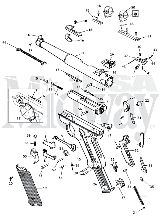

Recently NIB, time for cleaning; the bolt-stop access lever in the pistol handle doesn't cooperate in the 'pull out & down' phase allowing removal of the bolt.
Haven't made it to the "swing out & pull down" part. Per schematic I can pull out Part 33 but Part 32 won't swing out to allow the bolt removal phase. Tapping/lightly lubing thru the cracks hasn't helped. Any tips? ruger_mark_2.gif it's the 'bolt stop keeper'-'magazine'

that must've been the deal.....I did all the right stuff, put a small drip of Kroil in the crack & went to lunch......came back, jiggle-wiggle-giggle and pull on the part 33 with a vice grip and (voila)....all is well....
amazed with the gooey/crusty debris.....and the action of the little short Part 33 lever within it's position remains oddly tight but continues to loosen as I j-w-g-t-squeeze & use Words of Power....
complete disassembly & cleaning, all them parts are pretty slick now.

Turns out i was doing it wrong. The flippy hang down thing will seat in this part of the takedown dealy: 1520202681979-61635477.jpg
Get the majority of the pin/lever gig installed before your point at the sky salute. You can actually see the parts as you close it up to be sure you've obtained proper alignment. If the hangy swingy down thing is too far to one side or the other it will not work.

somehow I wasn't capturing the hammer strut right & managing to lock up the bolt as well.
So whatever you call them hangy down parts, I got it done.

what exactly was it? the pin thru part 33 or something else?
On my MKIII the takedown lever would come back but not all the way to allow the parts to be pulled free. You could snap it back in and the bolt could be drawn back but it felt funny like it was dragging. Then would not always fall forward without some assist. It was not cocking as trigger was dead. What the woman at Ruger said is the little strut was off to the side in there instead of in the little groove. Fix was insert mag, hold trigger back, While holding trigger remove mag, then while still holding trigger back hit entire pistol muzzle down on a hard surface 3 times. She has of course told me ahead of time to have good solid surface with something on it to protect the muzzle. I used a table with a piece of leather. After three hard blows was to try to pull the takedown lever. No luck the first time, she said try all the steps again, and there it was. Lever came down and out of the pistol. Then of course when put back together correctly all was fine again. I have never had this happen with a MKII or ever heard of it happening. So not sure if it does with them. She said she spends a lot of time walking owners through this same thing. I still love that little MKIII but I rarely shoot it now as I don't want to take it apart again. Just use that Gun Scrubber spray on it. It was a gift from my Wife when the panic was going on and these were VERY hard to find. She keeps saying she has no problem with it being traded off though and it will probably be. The MKIV system is just SOOOO much better.
