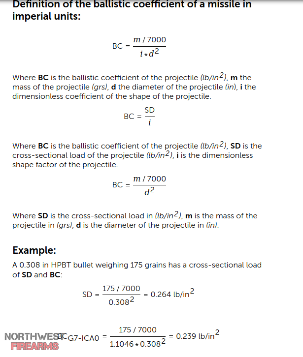

I'm confused, ballistic coefficient has nothing to do with your rifle, it is a mathematical equation used to evaluate the bullet in terms of external ballistics and flight characteristics in the real atmosphere. Here is the formula...
https://www.sellier-bellot.cz/en/products/ballistic-coefficient-calculation/
aaack. If thats the kinda math I gotta use I'll never figure it out.
