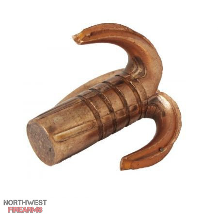

check this out
Maker bullets: Bullets
from 110 to 220gr
Geezz those look like little grappling hooks expanded. 168gn would be perfect. Use the 168 charts to work the load up with standard off the shelf 168's then swap these babies in for hunting. Wonder how they would do for hogs? Been invited a few times to do some hog hunts in OK. Have wanted to use the 300blk for that.

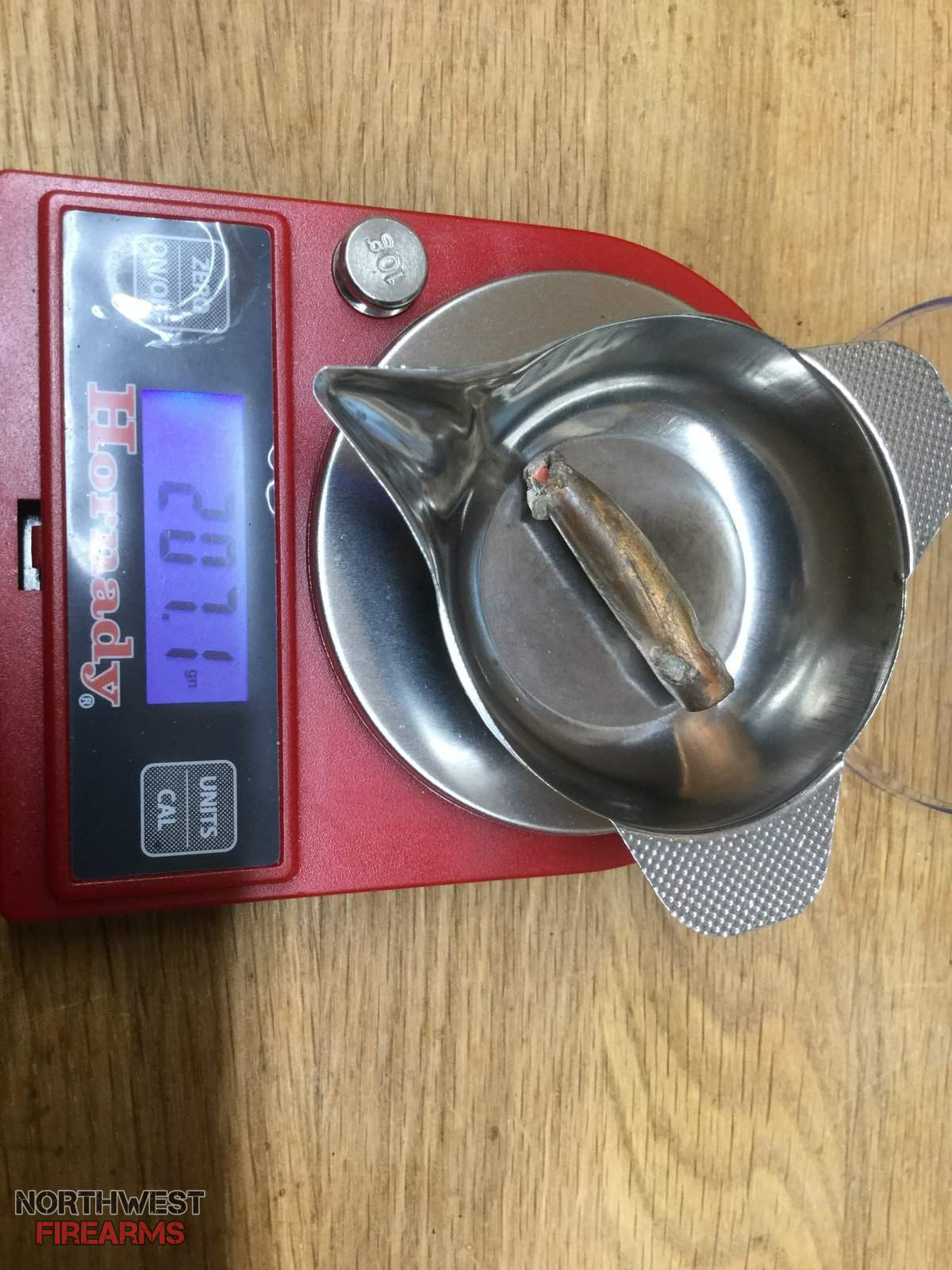

I load the Maker 500 gr subsonic expander for hunting with the 458 Socom. Load development was a bit spendy but I will be shooting very few for actual hunting. For 300 blk subs I use 11.7gr aa1680 with a 208 Amax ( no longer made) to get 1000 fps with a 9.5" barrel. It is very accurate and cycles action great. Although I killed a deer with this load using a headshot, I would not recommend it for hunting as it may just pencil through and not necessarily tumble. Here is the bullet recovered from the ground where I think it hit several rocks.
LOL it lost .9gr
Probably lost all .9gr to the rocky ground as I don't think the deer noggin provided much resistance. He only made it about 15 yds. and bled out.
That bullet looks to be a good match for the 300 blk at reasonable distances. Might be a bit explosive for point blank where I seem to encounter most of my Blacktails.
