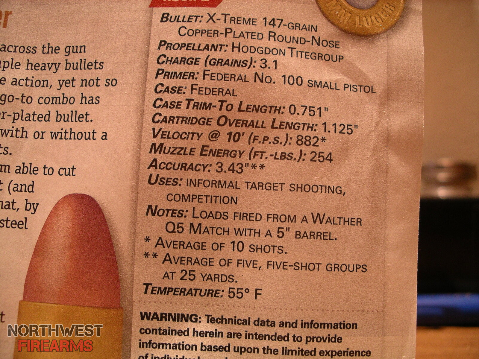

This was touted as an reliable Subsonic Load taken from American Rifleman September 2022:
1722563727688.jpeg I have not, as yet, tried this one as I don't have Titegroup in my armory's reloading facilities. (aka basement)
