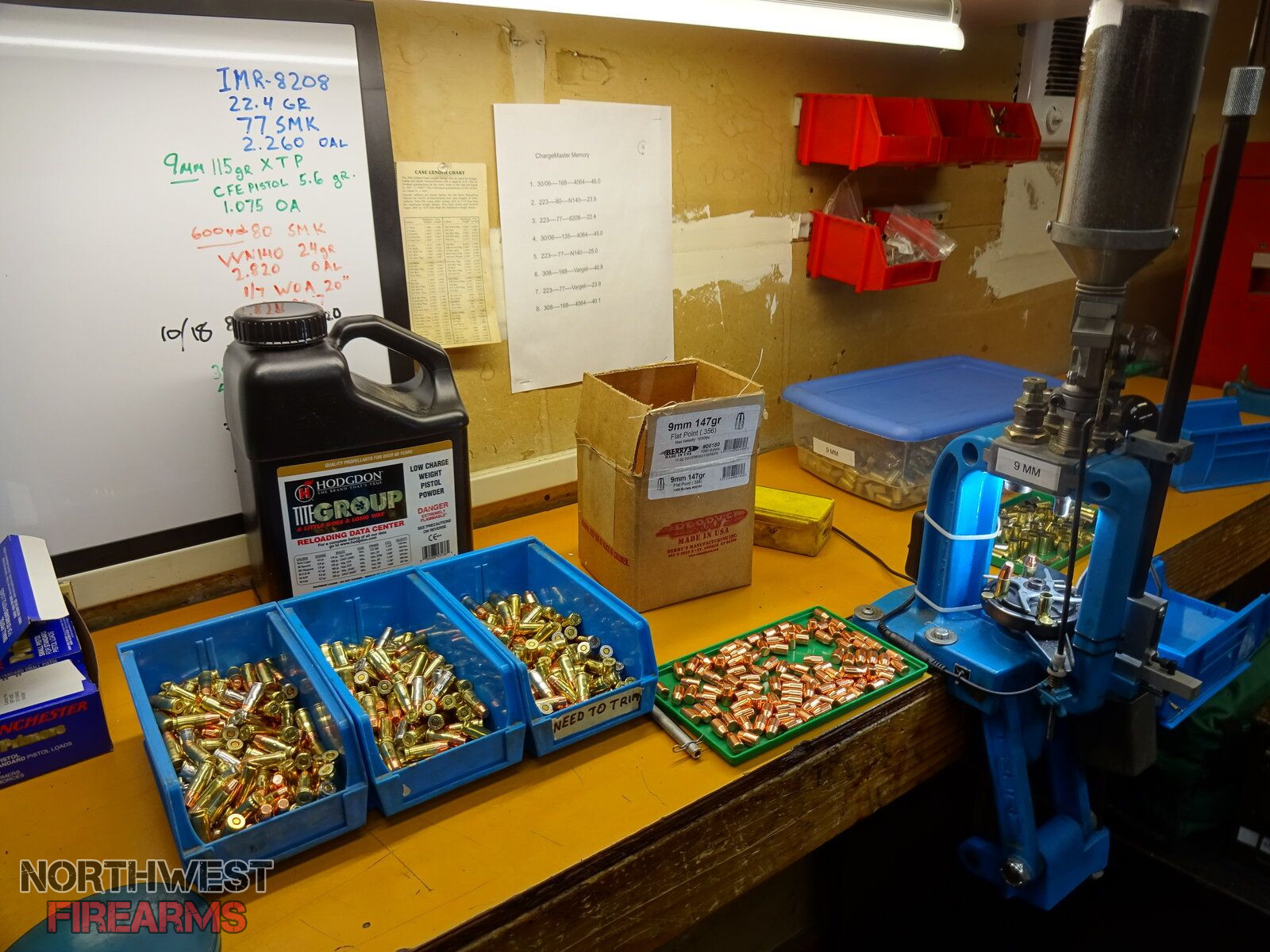

My 9mm target shooting load is 147 FP Berry's and Titegroup. I have reloaded a lot of 9 mm with
Blue Dot, Unique and CFE pistol. I have only used Bullseye in 45 acp loads.
