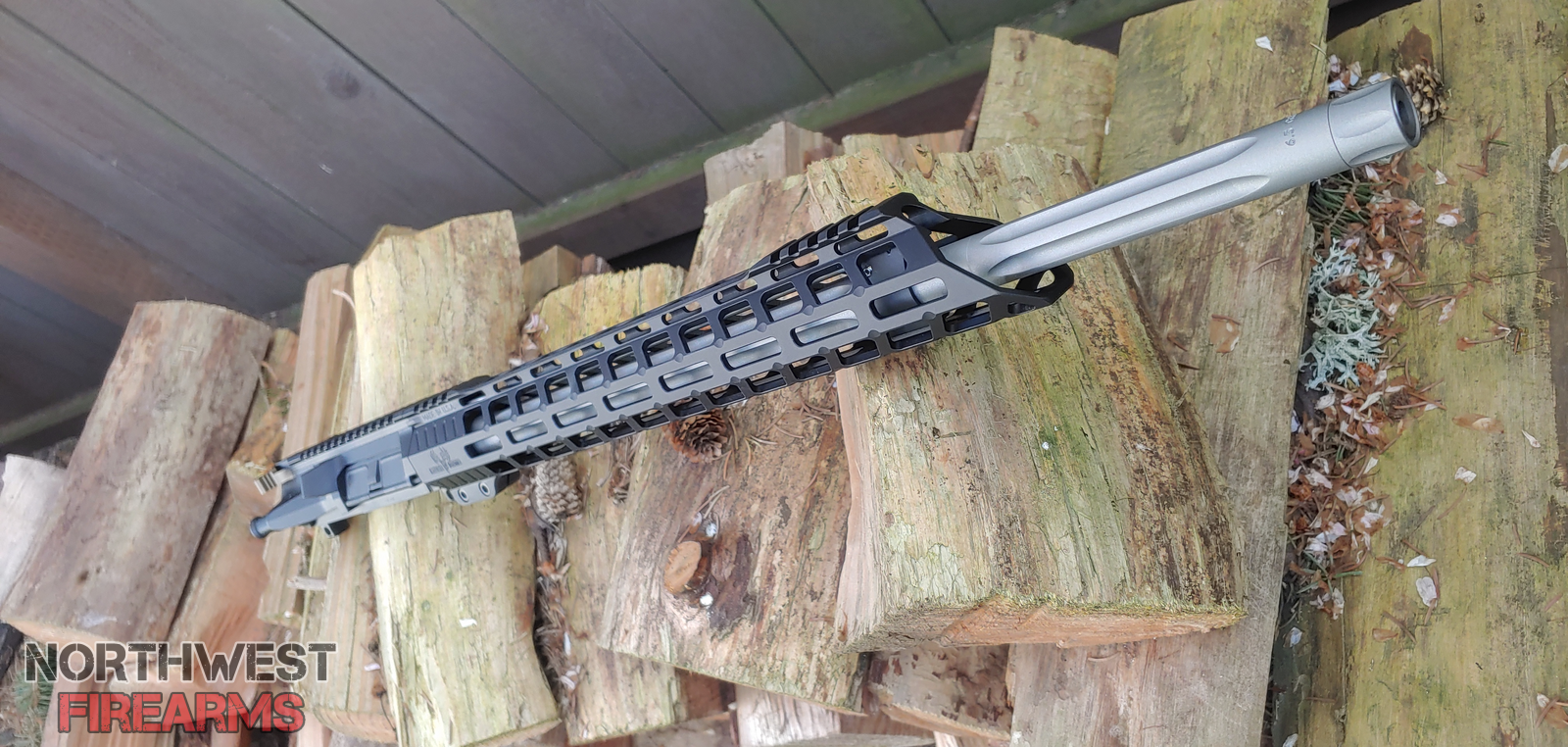

Help me choose the right stock and buffer assembly for my build: 6.5grendel 20inbbl rifle gas system, adjustable gas block. Note: I'll be handloading for this eventually.
Before I pull the trigger on the Luth MBA2 rifle stock and buffer kit, the 6.5 Grendel uses a standard 223 rifle buffer and spring right?
