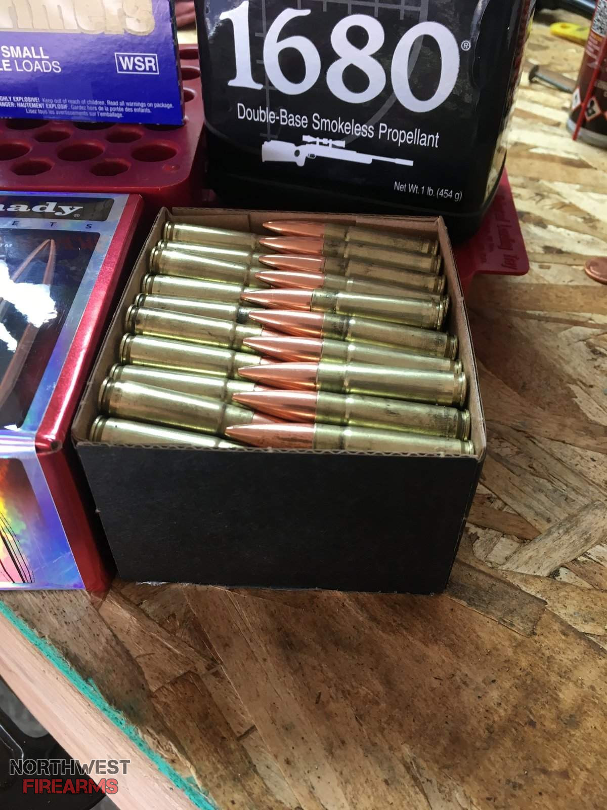

100 Rounds of Blackout Fits perfect in the Hornady box:D
^^ idk this photo wont delete. it keeps showin up every time i delete it.
