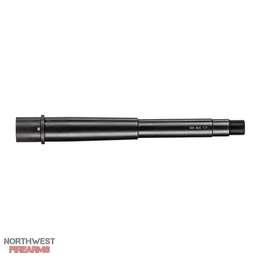

Here's the barrel I'm currently using:
The problem is that the narrow shoulder is not wide enough for the flash hider to square up against, so my suppressor is out of alignment with the bore. I tried using a muzzle shoulder ring to fix it, with no luck.
I now have a SCAR 17 flash hider mount on the way, which is designed to square up against the muzzle, not the shoulder. If this doesn't work, I'll be looking at replacing the barrel.
Some manufacturers, like Ballistic Advantage and Faxon, often flare the barrel diameter back up at the shoulder. If I purchase a new barrel, I think the Ballistic Advantage Hanson Profile is what I would choose.
I hope this helps!
