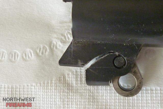

I have an ATI Officer's model stainless 1911. I know. I know. It was a pity purchase from a friend who needed money. Amazingly enough, that thing was more accurate than it had any right to be. I actually enjoyed shooting it. The other day I was at the range shooting some of my own reloads when the gun stopped because the slide AND THE BARREL both came backward and jammed up the pistol. It was tight. I couldn't push them back forward, nor even drop the magazine. Everything was locked.
At home I removed the magazine baseplate and removed the spring, follower, and all live rounds still in the gun. I placed the nose of the dust cover on a wooden block and beat the back of the slide with a nylon hammer until it finally came off the frame. Turns out the lug on the bottom of the barrel that holds the camming link had broken off of the barrel. Has anyone ever seen this before?

Bottom lugs broke off but, the link is still good?
I am not certain of the right terminology. I am calling the piece that is part of the barrel that the link attaches to, the lug. The link was still attached to that piece, which had sheared off right at the surface of the barrel (or chamber area if you will). The link was still held in place by the link pin. I wish I had taken pics. Too late now. The whole gun is at ATI.

Take a look at the very bottom of the lug. It looks like the end is battered. A look at the frame where the lug contacts would probably show it better. The nature of the crack points more towards the lug being the culprit.
