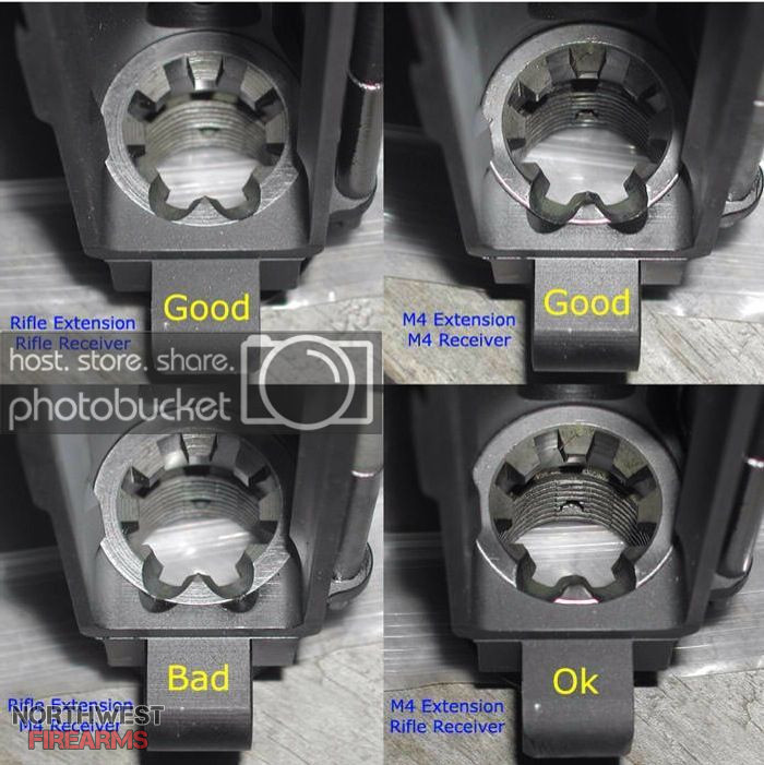

Not sure of your knowledge base on this stuff so I'm just throwing this out there. A rifle barrel extension is not the same as a M4 barrel extension, there is also a difference between rifle upper and and an M4 upper, the rifle lacks feed ramp cuts the M4 . Mixing them has varied results, some not so good.
Right, I'm definitely looking to see whats out there before moving forward. I will wait a bit, but if nothing is available within a reasonable time I will be a complete retro kit which should eliminate any issues with barrel/extensions not matching. Such as:
