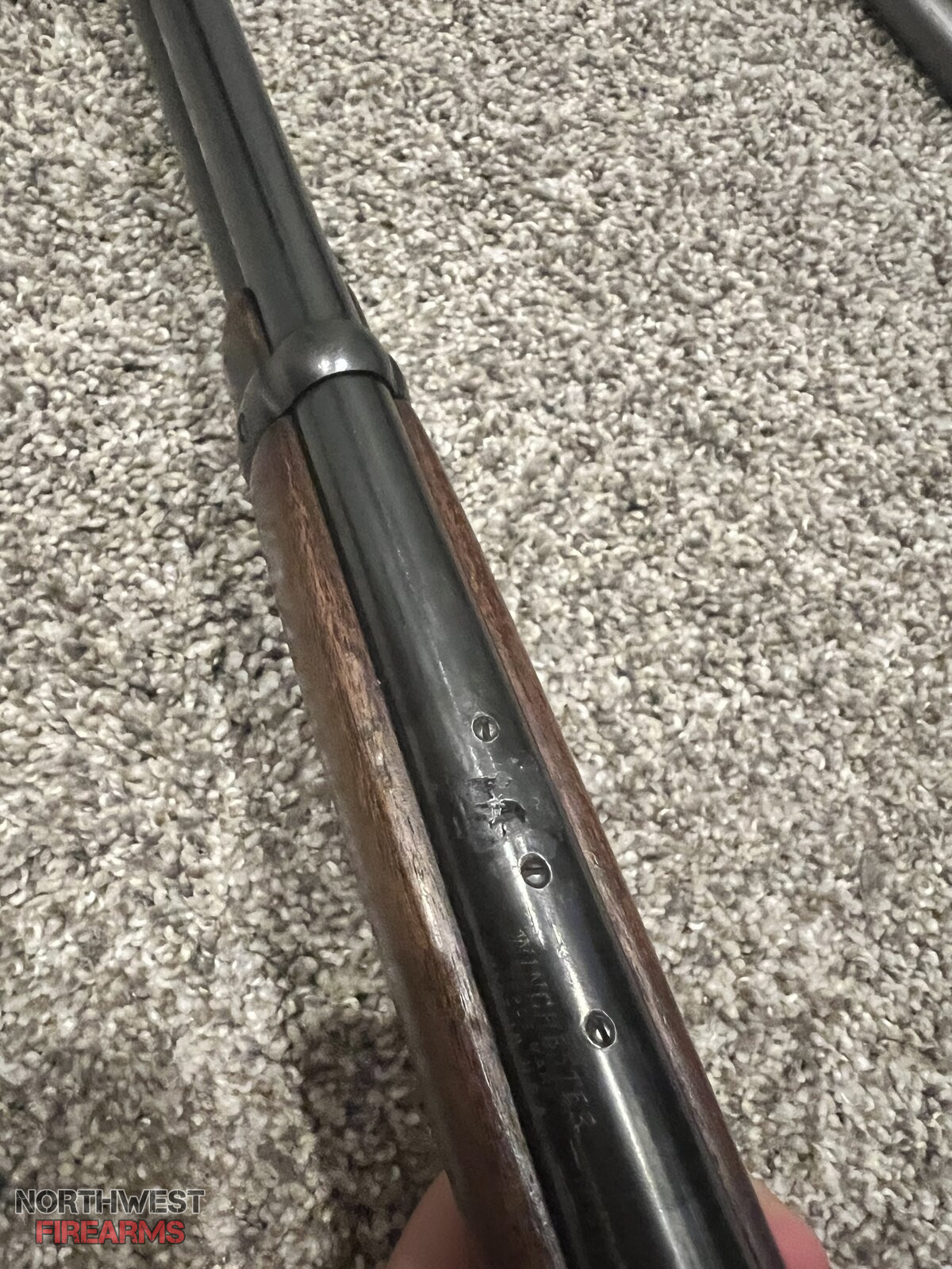

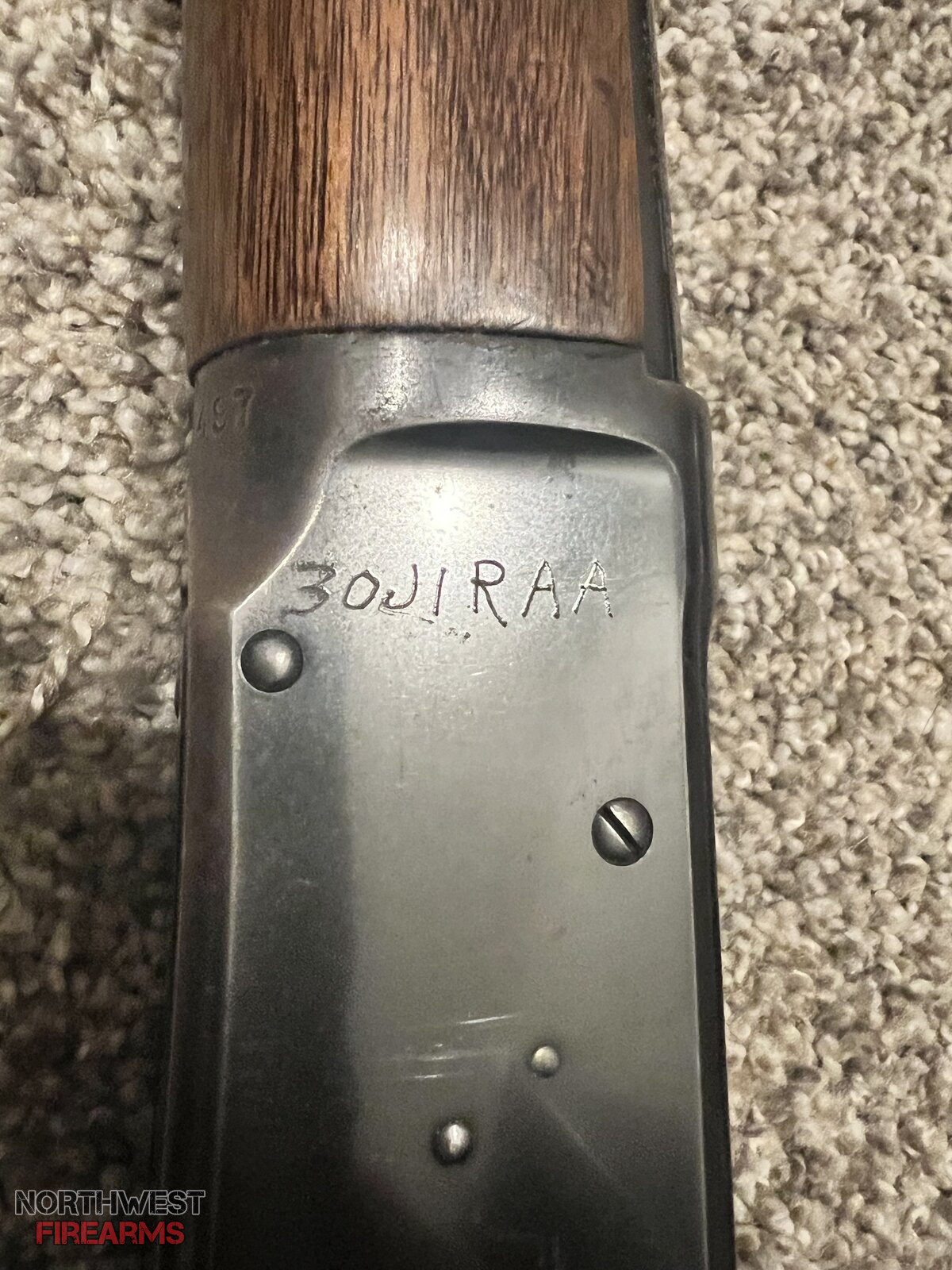

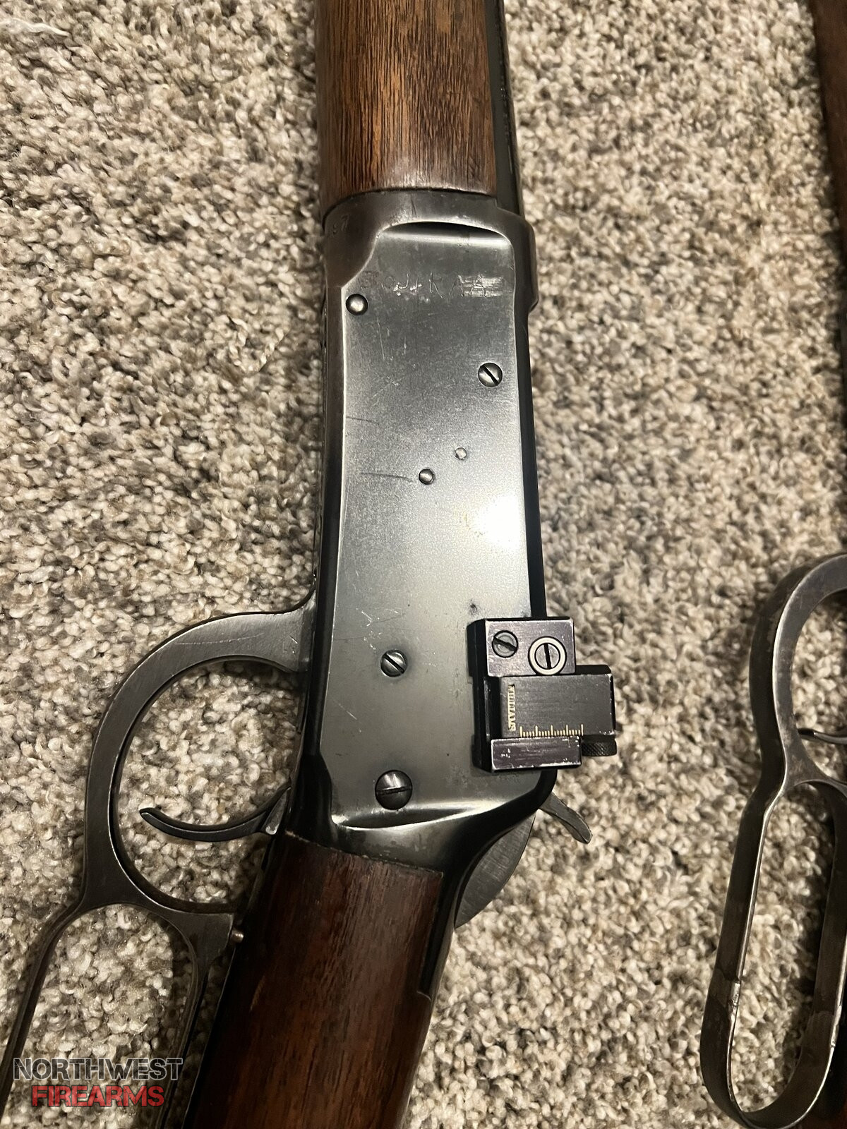

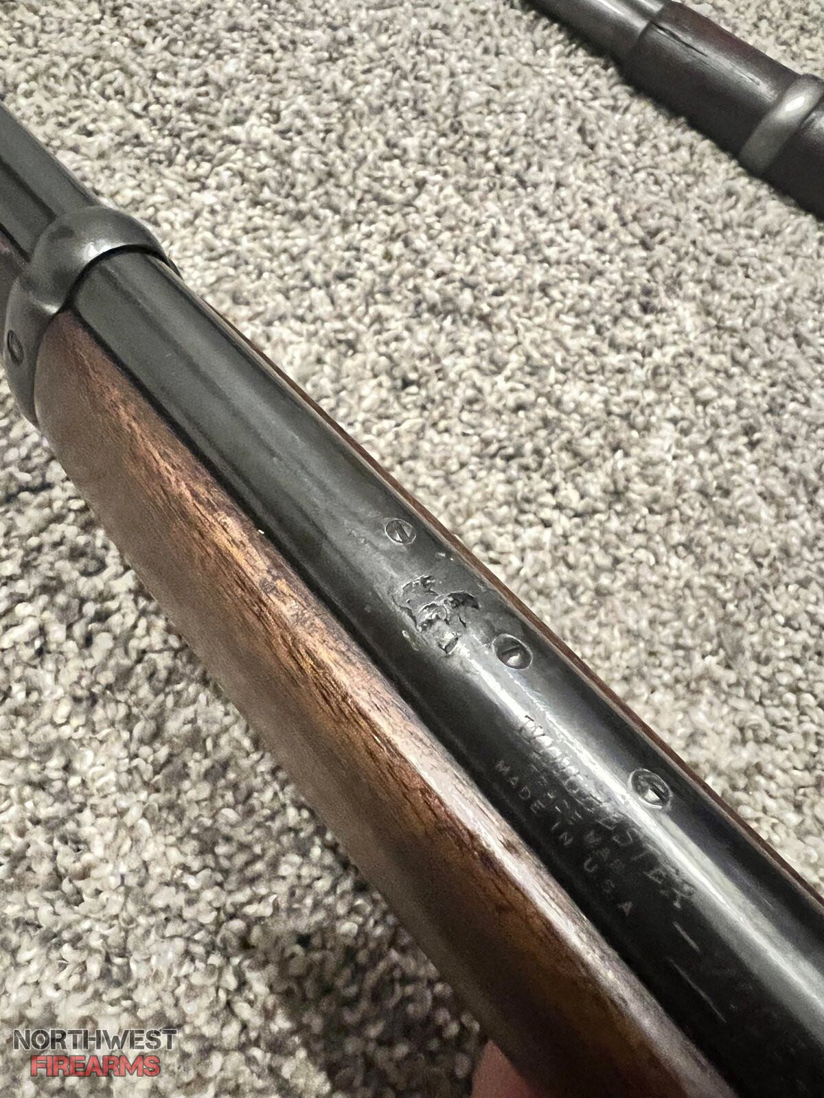

I have this Winchester model 94 30-30. Manufactured in 1956. It has some issues. Curious on value or possibility of fixing.
It's the one in the left with the peep sight. Someone hand engraved this number on both sides. Also booger welded the dovetail sight mount. Why anyone would do this is beyond me.
Otherwise great gun. Shoots well. Pre64. Peep sight works fine.
Curious on value as is, and if anyone knows someone who may be able to fix the sight issue?

To 'fix' the sight issue is going to require a new barrel.
That weld is so porous and bad a new dovetail could not effectively be cut. Even if it could it would require polishing and touching up with blue which would still be noticeable. Although it shoots well, who knows how deep the weld went. Very unfortunate.
The number on the frame you might have to leave. While unfortunate as well it is not affecting the function.
Thank you for the information. It is what I was assuming. It is unfortunate but luckily the gun does shoot and function well.

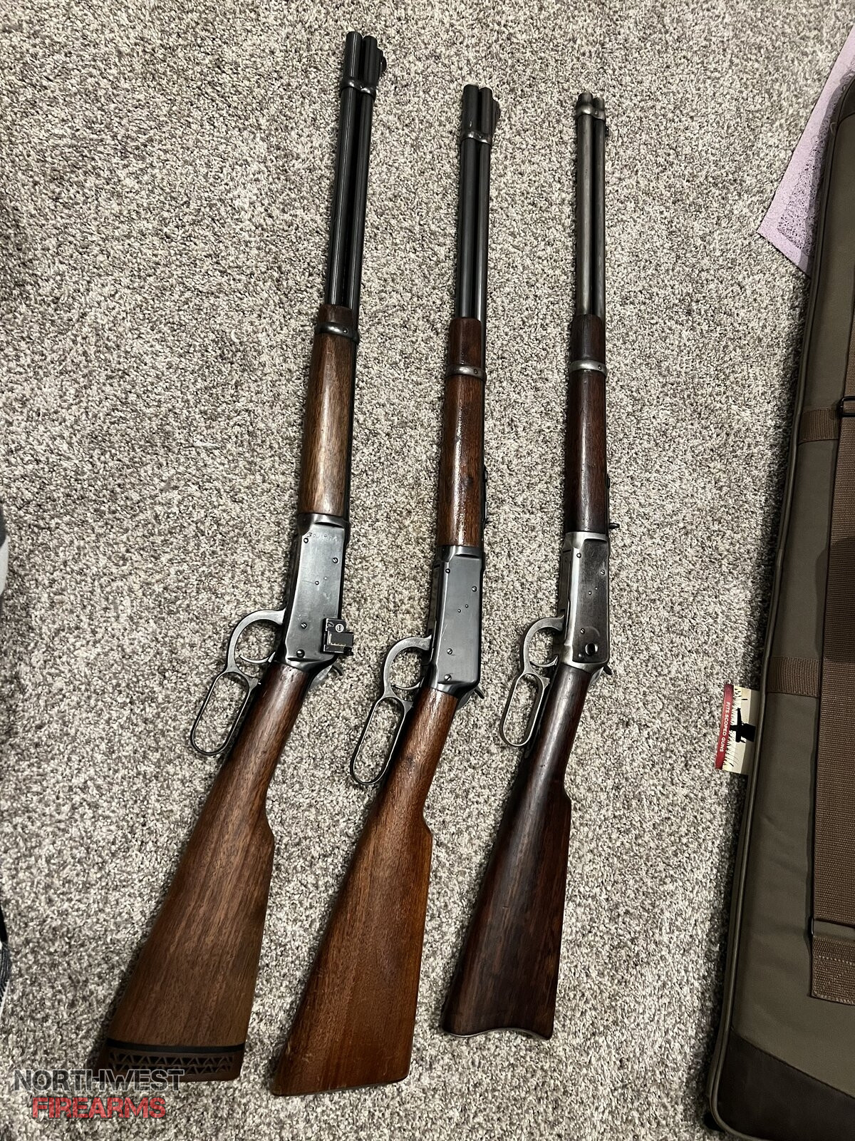

Yeah it's got a few things going (wrong) for it. It's a good shooter. Working parts are in great shape. But I agree. The other 2 are family items. Other 2 are early 1940s in great shape and 1924 in good shape with wear on the bluing. Those I'm keeping. I just don't need a third
Easily repaired by any competent gunsmith that can Tig weld. I've welded up an blended numerous DL numbers. Barrel can be fixed too. Porous welds don't mean anything. Machine that out, weld , anneal an re cut if needed. Plug screws weld over an blend. Then heat the welded areas to blend an stress relief before re blue. Cost you about 2x what buying a nice pre 64 will get you. But it's doable.
