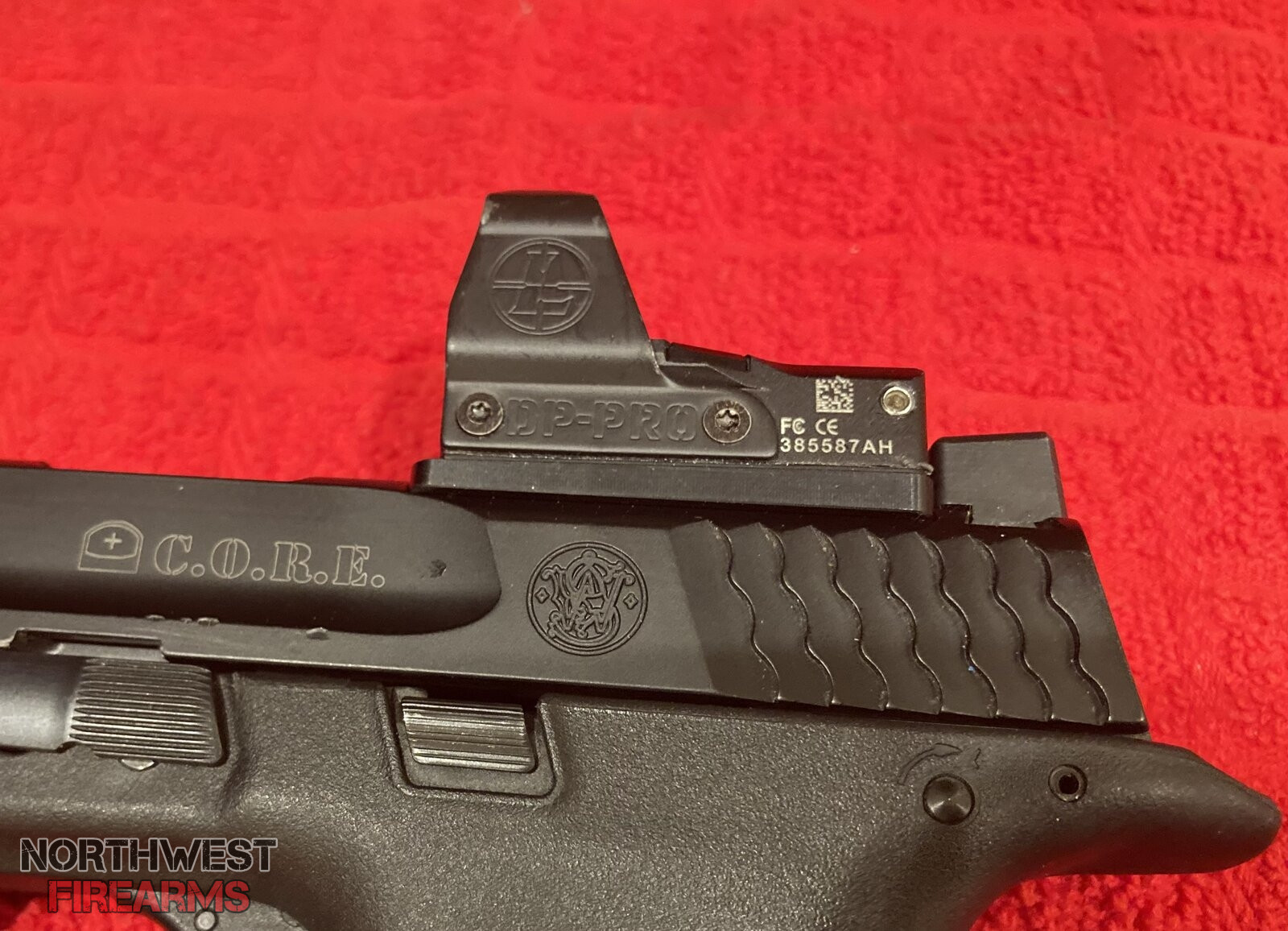

I recently picked up a plate from Leupold to run their DDP on my M&P 1.0 CORE. That plate is all metal goodness and is THiCC with two C's! The DPP is a really tall optic and this only adds to the overall height. No big deal, as this gun is strictly a range gun.
I'll try and get some pics and post them up.
