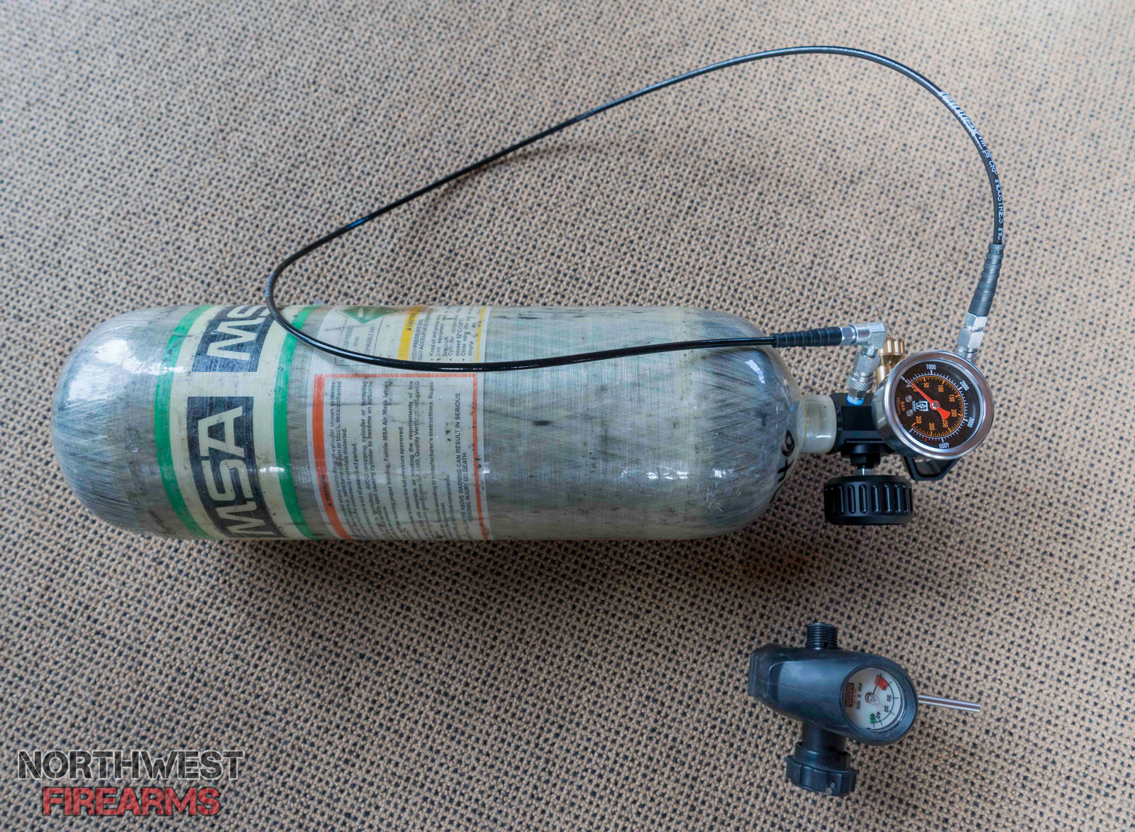

On Ebay I purchased a used fire department air tank for $55. It works great. 66 Cf at 4,500 psi. I did replace the regulator with a nice one. The old regulator is in the photo.
Sounds like a great deal. I do know that every so many years they are "supposed" to be checked and certified so have to "wonder" if this one was ready and they just did not want to bother??? Not sure why they do as in do the damn things just "wear out" somehow? Anyone know if the ones made with Carbon Fiber somehow degrade or something?
It's actually the aluminum inside of the CF wrap that gets checked. Pitting, water, contamination from filling, the regulator assembly and so forth.
