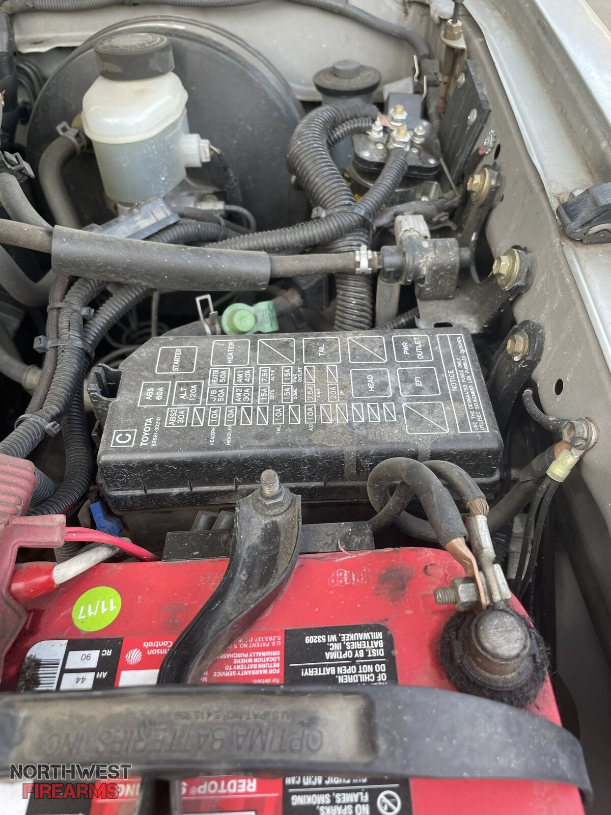

Dunno if this helps
B05C3C6E-BDD7-433D-B93D-0ACF64F84E0A.jpeg F54F89A3-21D9-4666-9C66-D1A89BFEBD0C.jpeg

Well it looks like you have a battery isolator for it. If it works it should be separating the batteries when the truck is off. The aftermarket accesory wiring should all be on the house battery side which would keep your starter battery from being drained if everything is wired properly. Do you know if it connects the batteries when the ignition is on? My isolator has a setting on the switch for emergency start that connects both batteries if your starter battery goes dead. Have you checked both batteries with a meter to see if they're both dead? If this truck were mine and it sat outside for extended lengths of time I'd install a hundred watt solar panel on the canopy and a split charge controller that will feed both batteries. With no serious drains it would keep your batteries topped off without ever needing to plug a charger in.
When the ignition is on seems like it's there cranks a lot harder. I like the solar idea but seems sketchy in the city like cool but sitting on my truck seems like a red flag. I don't need any drama.
You got me thinking. If I read correctly that second battery should be isolated when the power is off. And should provide power to start.
