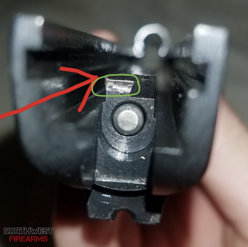

Couldn't find a serial number on the barrel, but all other numbered parts match. Here's what I did discover, when the hammer group was removed, the hangup stopped. I tried reinserting parts of the slide one at a time just to be sure, and everything (slide, barrel, spring, bushing) moved freely as it should. Naturally I thought it might be an issue with the hammer group, but I disassembled it, couldn't find anything wrong. I did, however, notice there's a small bit of metal sticking up from the surface on the one side of the firing pin housing, towards the rear of the slide. It might be hard to see in the pictures but it's on the left hand side when looking at it from this angle. The other side doesn't have that tiny piece of metal sticking up, so maybe I'll need to file that down a bit?

The area circled in green is where the soft slides wear prematurely. It appears that you will first have to dress that raised section of metal down (the red arrow) and then file or stone a radius on the worn (green) spot which cams the hammer back - that will greatly ease retracting the slide from hammer down.
Interesting. The slide was still hanging up even with the hammer fully cocked, so I wasn't sure if that made a difference.
Alright, there is definitely something in the hammer group causing the slide to hang up, but I can't for the life of me figure out what it is. Might have to take it to a gunsmith. I'm not too keen on filing down or messing with anything that I'm not 100% sure is causing the issue.

I don't recall anything like that tab of metal sticking out on any of mine looks like maybe hitting the hammer deformed it or maybe was never finished from chicom..that could definitely hang up things…sounds like your going to take it to a gunsmith I would if your not comfortable with filing it…like already suggested I'd file that down and then look at the hammer see if it's needing filed square or something is out of whack with it could be a replacement hammer or ? Looks like your on the right track though.
