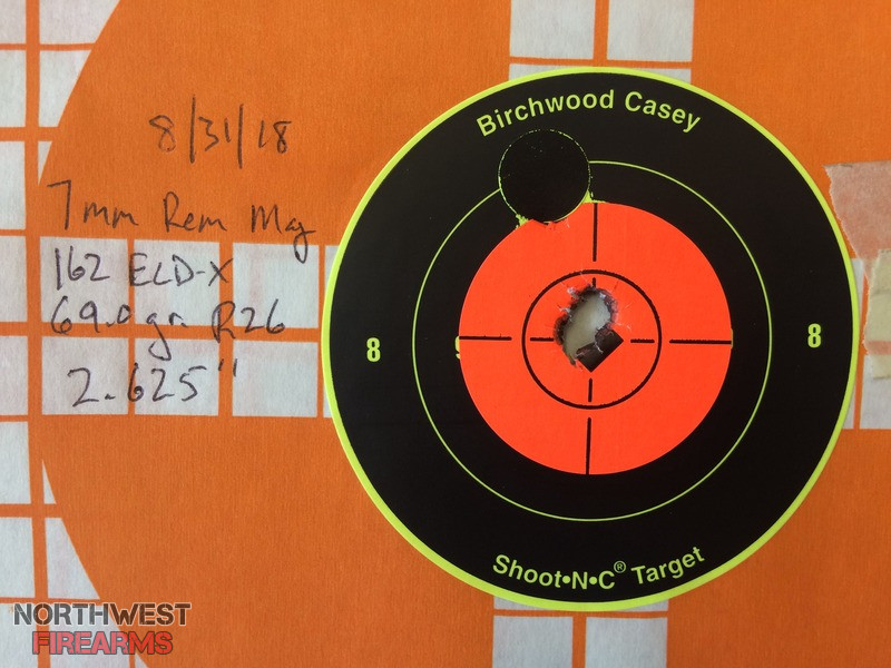

Why not just buy a Tikka in 7mm Rem Mag? The ballistics are nearly identical and the Tikka barrel is 24". I have one. Tack driver.
Pretty average performance for this rifle. The one I sold to a friend was similar and my brother's is about the same.

I thought the 7mm-08 was the chit, I don't have one but know several guys that do.
It is. I used to have 4, now I'm down to 2.
I only bought the 7 Rem Mag to pìss off my brother. He bought new, replaced the stock, added a brake, swapped out the recoil lug, and spent big dollars on a scope. All before he even fired the dang thing.
So I bought used, replaced the recoil pad, and installed a used scope. It shoots just as well as his.
HA!

sounds like a 7mm-08 would be perfect for a young shooter.
