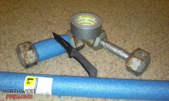

Maybe get one like this and drill though the forearm before you add the shoot, put the nuts inside and the Rockite will make sure they don't come loose
Very good plan.

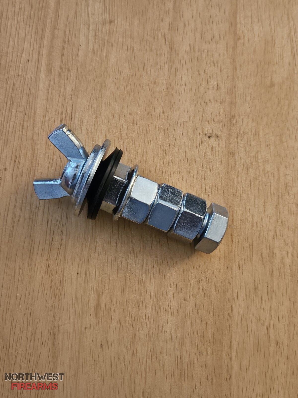

Time to make some magic happen.
$9.50 worth of hardware.
I went with 1/2" hardware. It was cheaper and the largest wing nut they had was 1/2". That will make it easier to move the weights on and off the stud.
I hope I can thread a 1/2" bolt through a 3/8" hole. Otherwise I will have more digging to do for a larger bit.

Done!
I need one more large washer to place between the wing nut and the weight plates. I am also going to search for some tubing that will tighten up the fit between the weight plate holes and the nuts. 3/4" hardware would have eliminated that slop but this will function fine.
This will give me a 23+ pound rifle for next range trip. Bring on the full house rounds.
