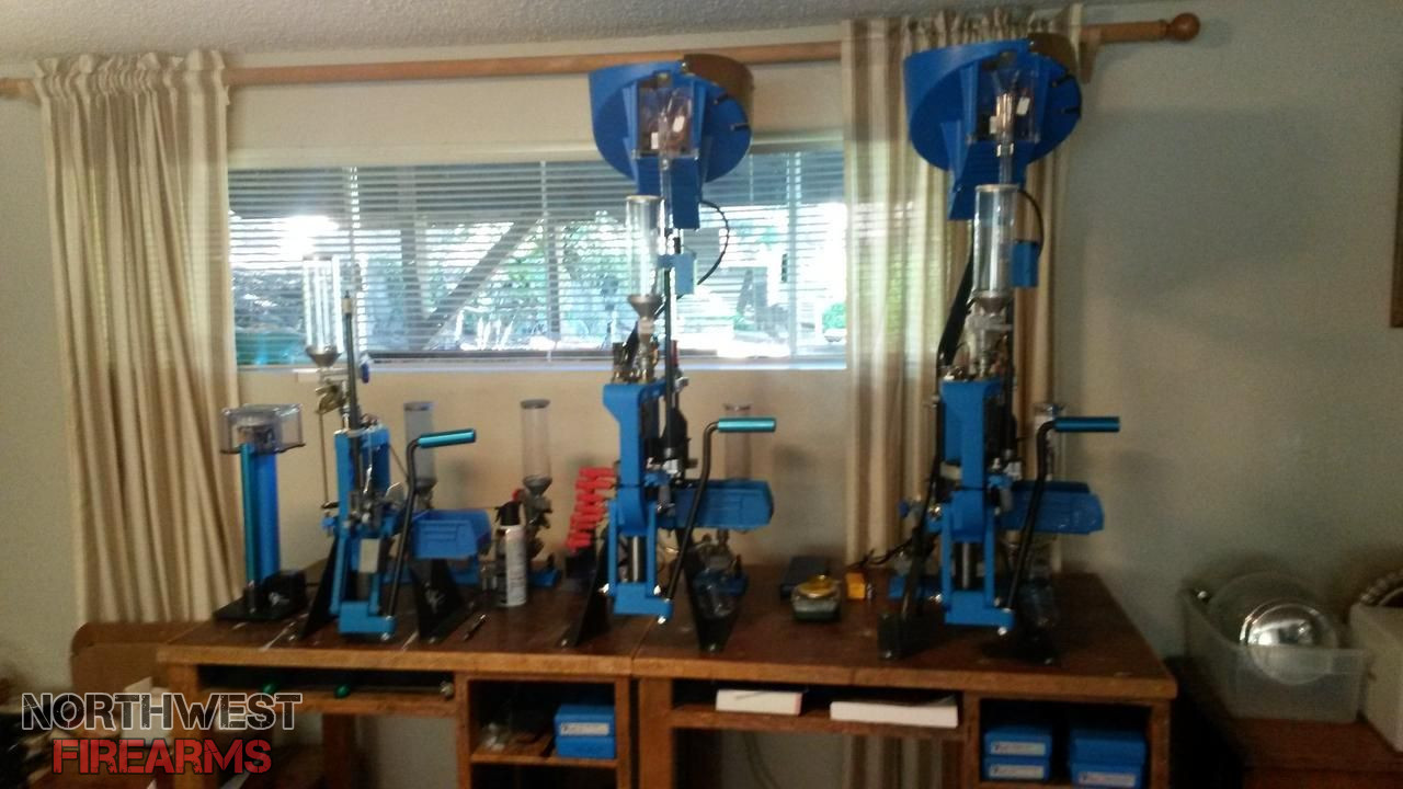

I just bought a Dillon 650 XL reloader- mainly because I live in Kommiefornia and I don't want to make Sacramento liberals richer in 2018 whn I buy ammo. I bought the press with a .223 Remington conversion kit installed- I also plan to reload .308 and 9mm. I know there are more precise reloaders for rifle rounds, but I learned how to reload on a Dillon, and it seem a good choice to me. looking forward to making bullets again.

Wow! Super layout! :)
