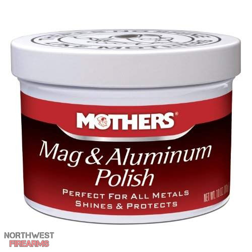

Use Mothers Mag Polish with a cotton cloth after you are done with the sand paper. It will get it extremely shiny and will remove fine scratches, works even better if you use a buffer or Dremel.
The more times you go over it with the mothers the shinier it will get.
Thanks Red, they have it at my NAPA store, I'll give it a shot, someone maybe you?? recommended it after polishing his revolver, but I knew I had to get rid of the grind marks first, they were way too coarse to just rub out with a cloth.
