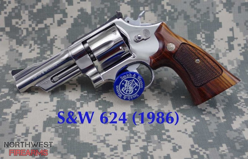

This is an especially battered 624 I polished using the above process:

That looks awesome!

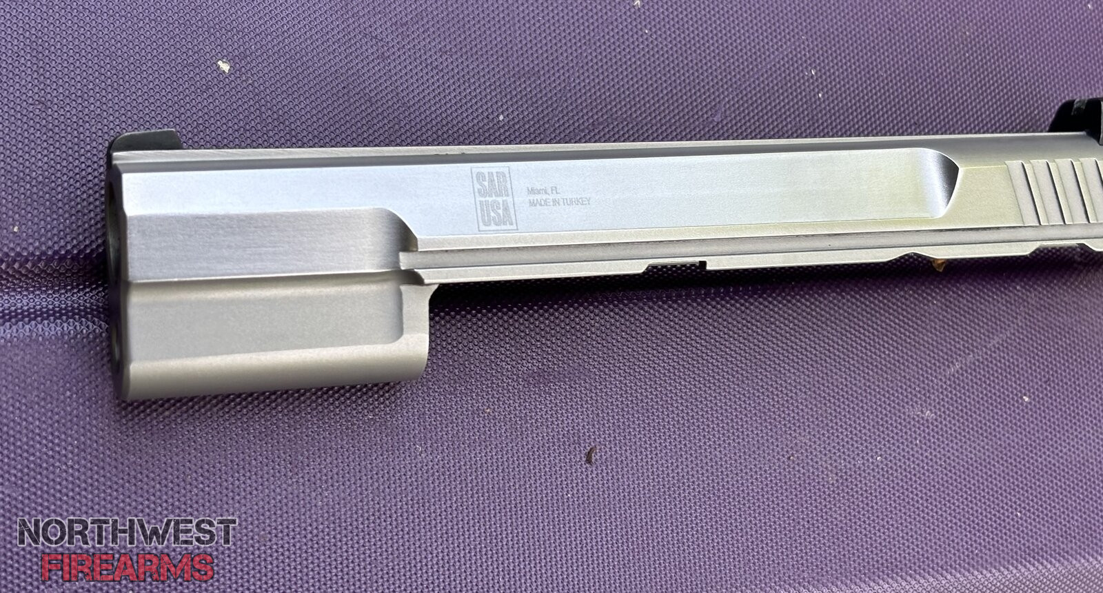

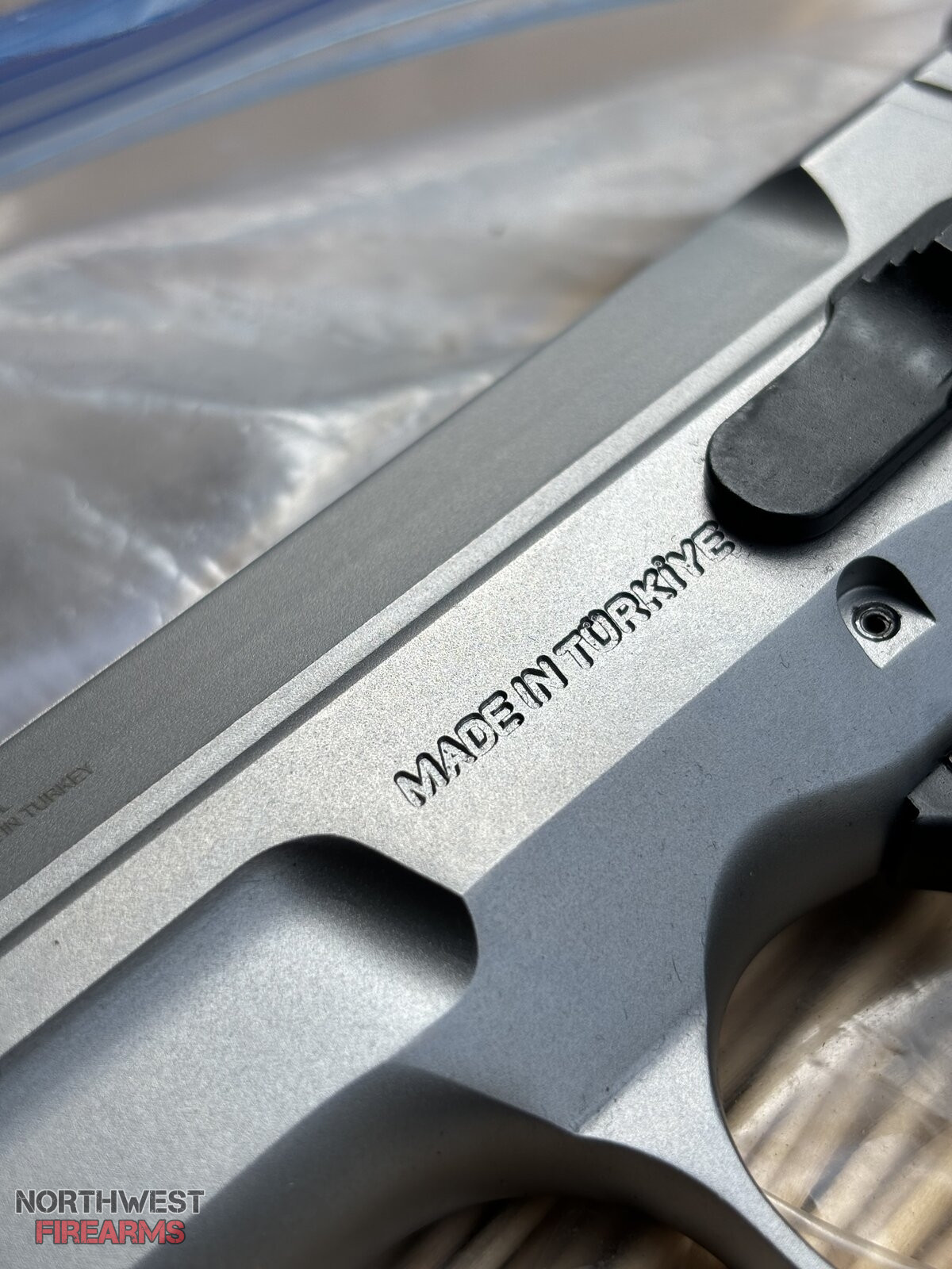

How do you spell "Made in Turkey"? Might be hard to sand out those extra letters :p
Definitely got to do that. Cuz then I can claim it's "custom". :rolleyes: Man if I see the word "custom" anymore in an ad title, I don't even open it. Or a Glock ad for $1500 or more cuz it's "upgraded".

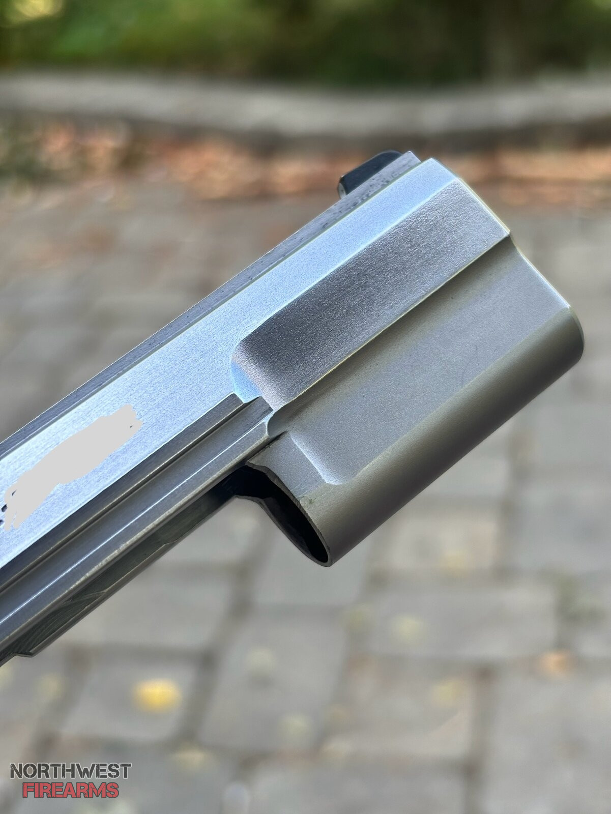

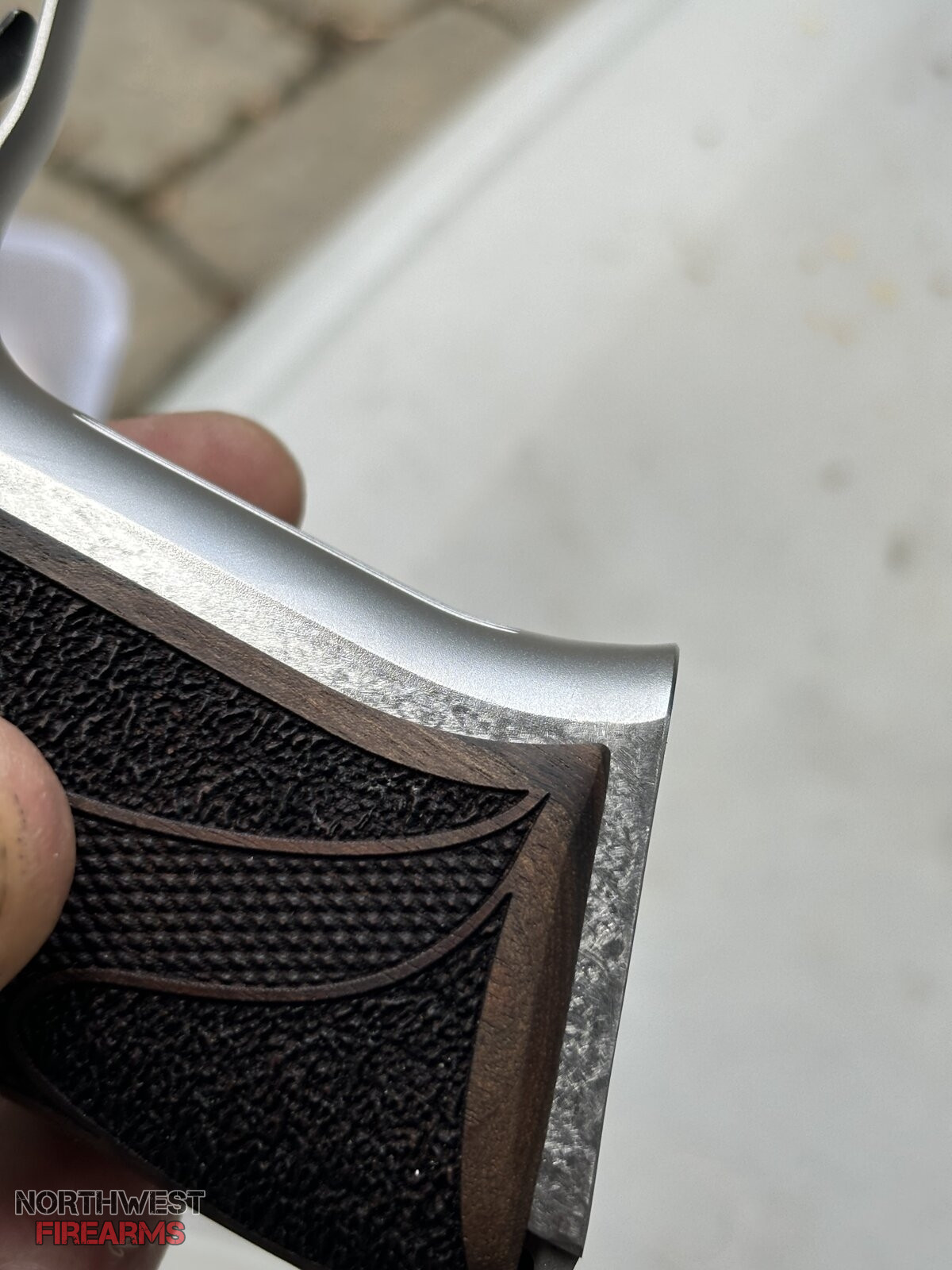

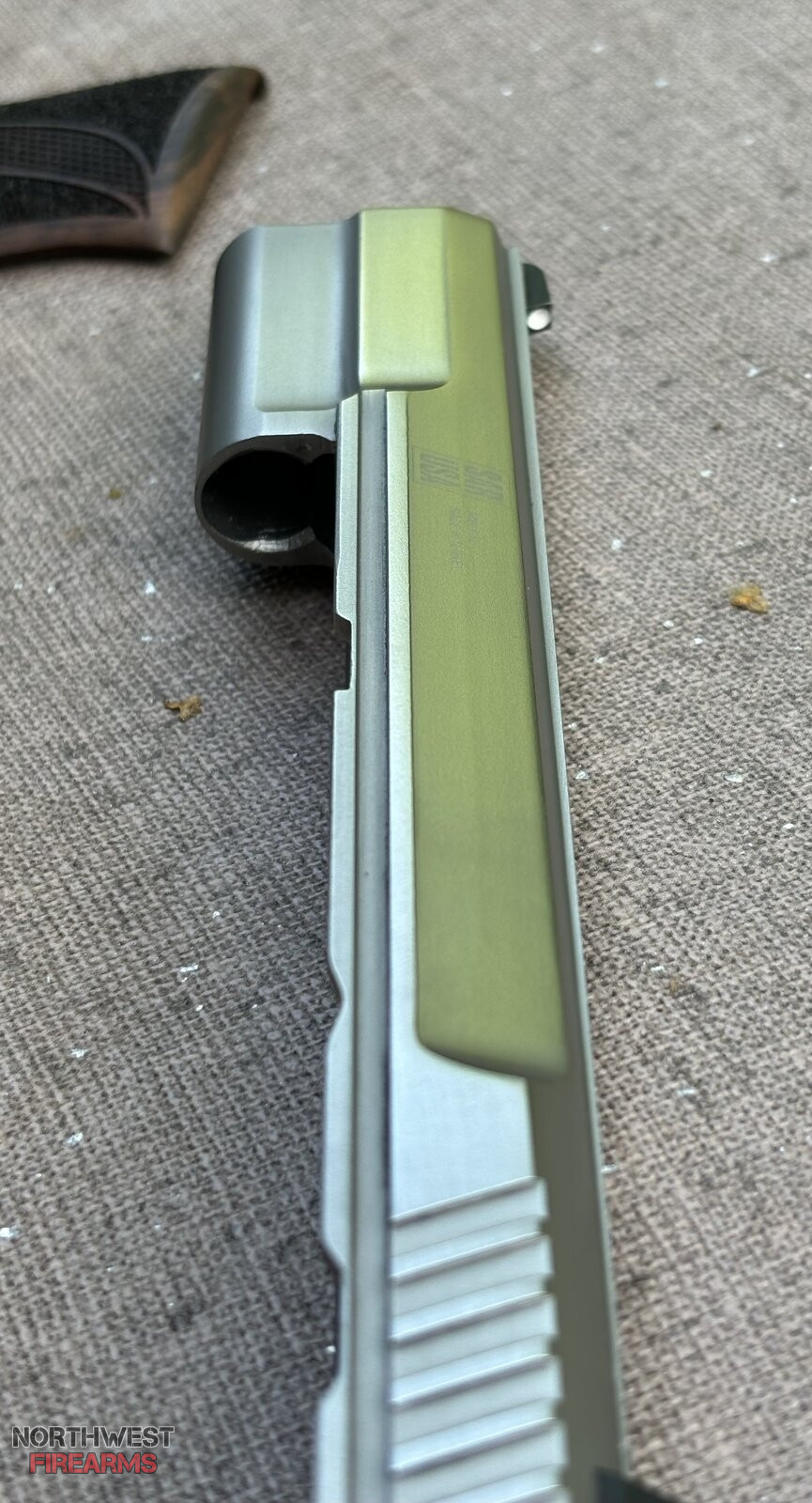

Technique to produce results I want found! I used Mr clean magic eraser (which itself is a mild abrasive) and mothers metal polish. Results are hard to show in pics but perhaps you can see the polished (top of slide) vs unpolished (little section of bottom front slide). Takes just a few min to do entire slide (polished portion I mean). Hard to see in pics but the "shiny" satin in contrast with the matte is very noticeable in real life. It's also extremely helpful to "breakdown" (take off the high spots of the head blast) the finish prior to using magic eraser. Sandpaper, scotch brite pad, valve grinding compound with polisher can all do this.
Tried but didn't like due to too much work and/or look: Various sandpapers, scotch brite pad, steel wool by hand. With small polisher I tried: diamond cut compound, bullet fire lapping compound in 220, 320, 600 grit, valve grinding compound, polish by itself. The method above creates a shiny but same texture surface with very very little work. The magic eraser component is critical imo.
As taroman said, if want a mirror finish the only way is sequential steps with sandpaper then polish. I'm not gonna put in 1/100 of the time to do that cuz not worth it to me. But on another gun it may well be worth it especially if it turns out like taroman's revolver.

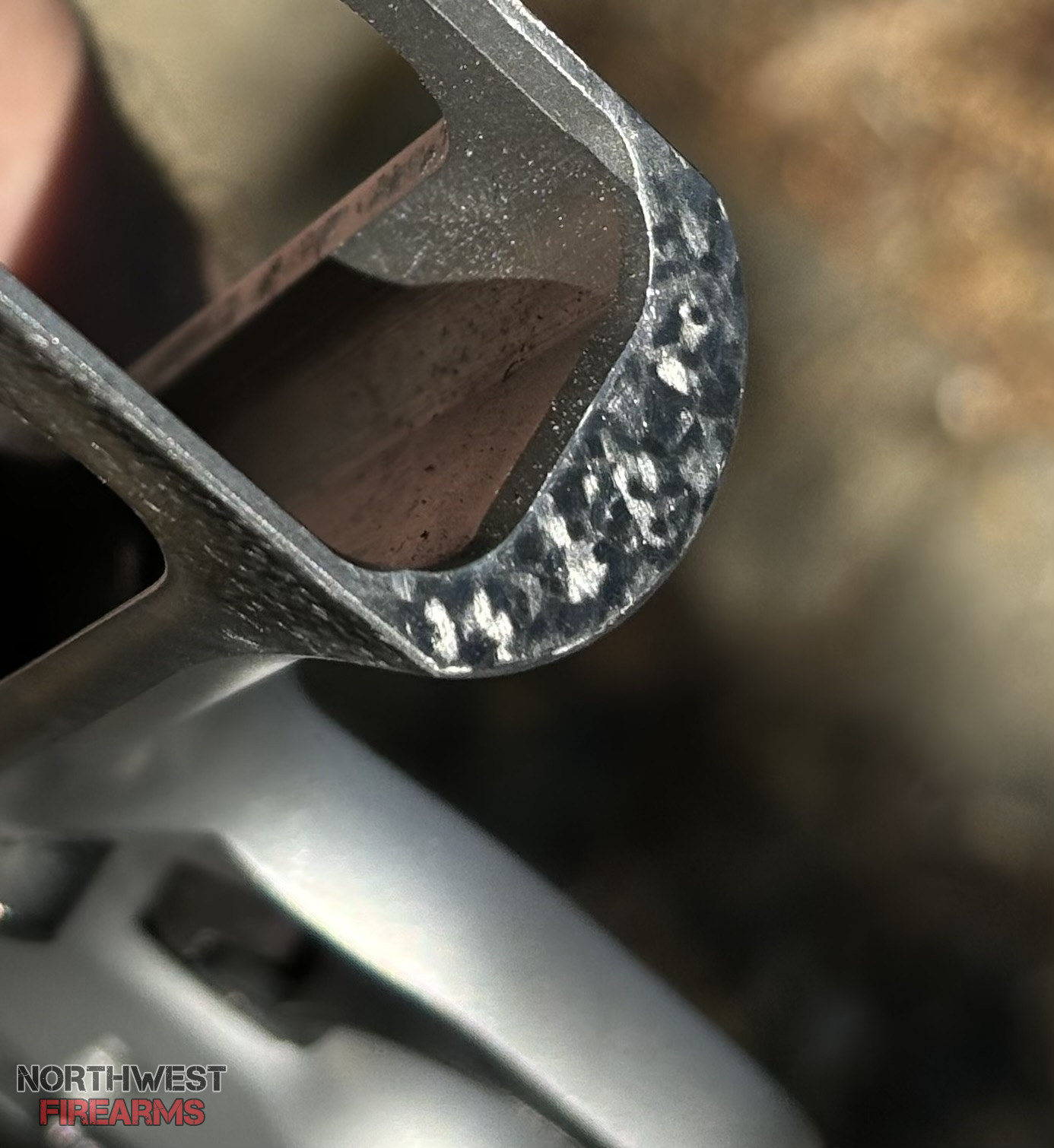

Playing around on frame under the grip just to see what different textures would look like. Brushed look is easy of course just sand paper. Tried dremel with coarse grit sandpaper going from different directions. If you do it from different directions it can creates flashy "facets".
Mild "facets", more of a texture really
More aggressive "facets"

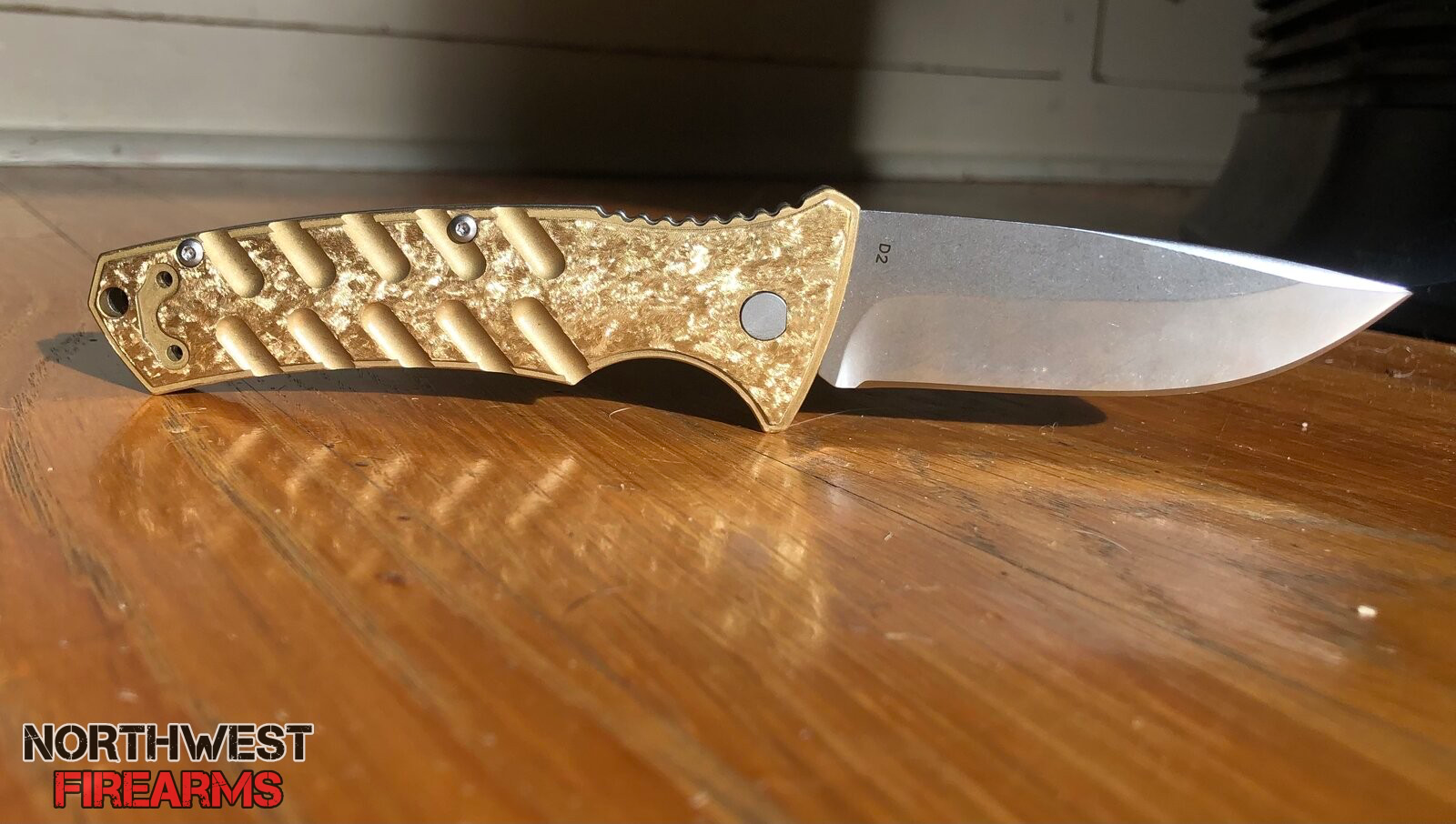

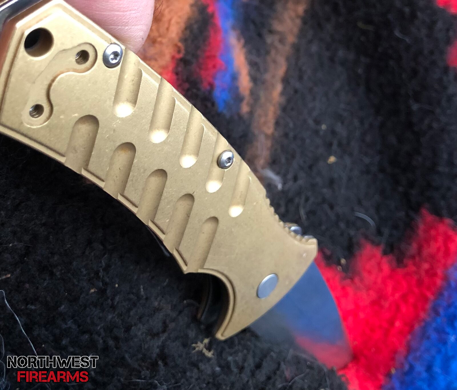

I've done this kind of look before on brass knife scales. Takes a long time but I kinda like the look.

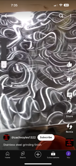

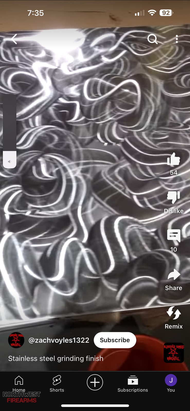

A similar effect can be created with a grinding wheel from different directions. Pic from internet:

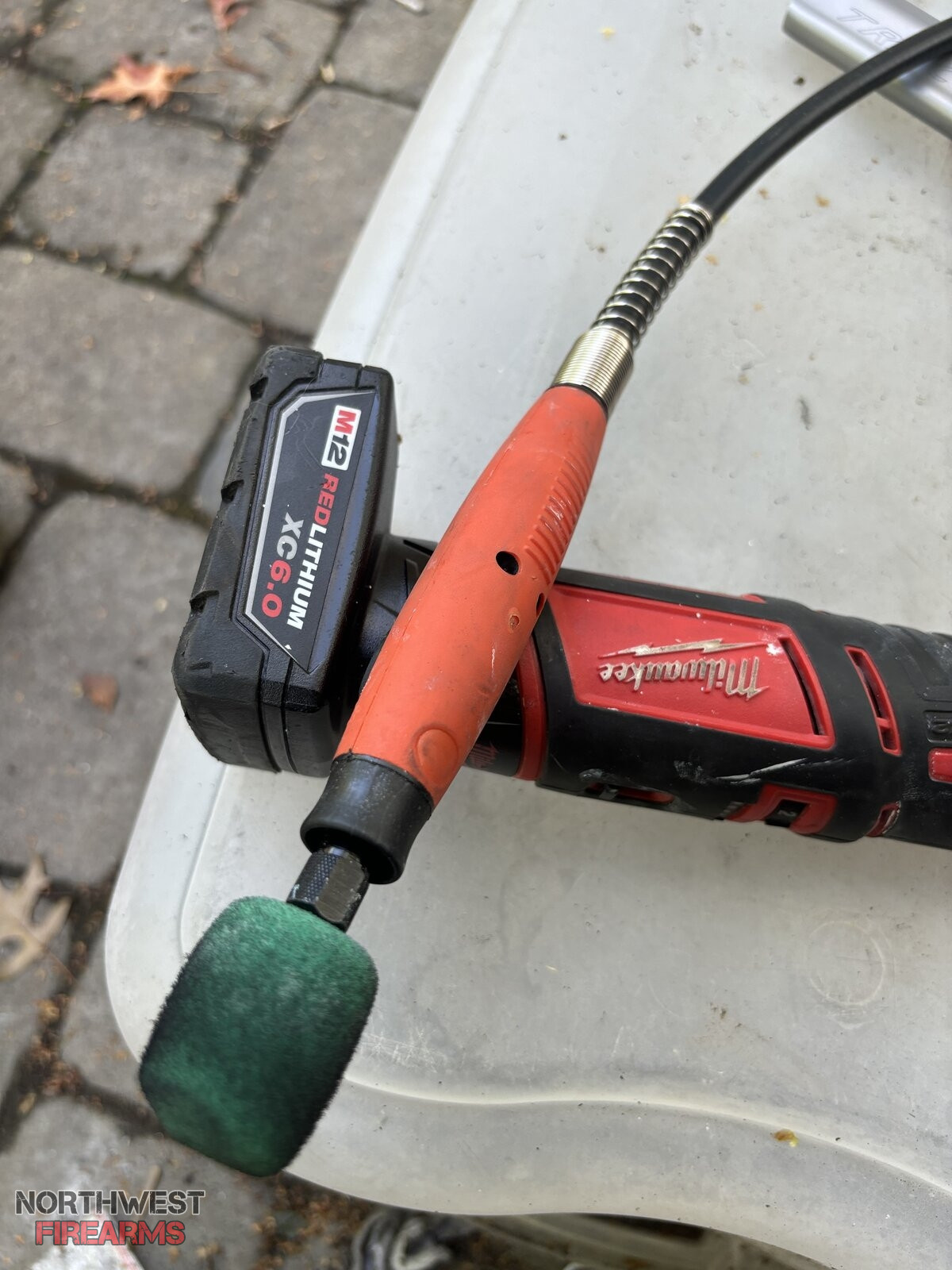

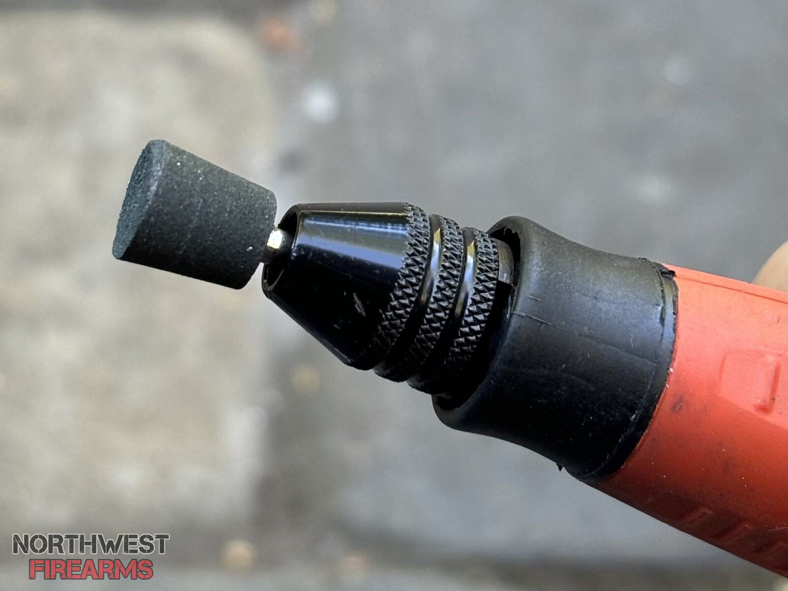

To cut the little facets I cut the end off a standard dremel semi soft polishing bit (to make a sharp edge) and cut "facets". Then rotate and repeat. "Cuts" are not deep and surface is smooth. The cuts I did earlier shown in an above post were with sandpaper on dremel. Those were deeper and left a non-smooth finish. The green semi soft tip just polishes really not cut into metal.
Here is how frame turned out. Takes about 10 min to do frame (one side) cuz you just tap multiple places with dremel, turn gun and repeat sort of rapid fire.

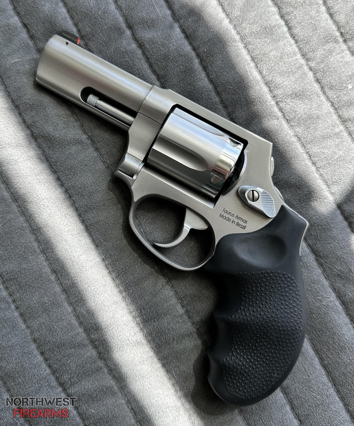

Was looking online for a pic of Taurus bead blasted revolver with only the cylinder polished and saw this photo. Certainly makes the gun look more interesting and unique.
I was thinking maybe Polish cylinder only and leave cylinder flutes matte.
