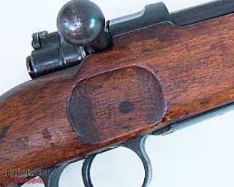

Maybe a reworked Wz.29. Stock looks like a Wz.29 stock for sure. Handguard has dowel reinforcements. Is there a dowel reinforcement in the bolt cutout? Like this? Any circle Z stamps on the metal?
