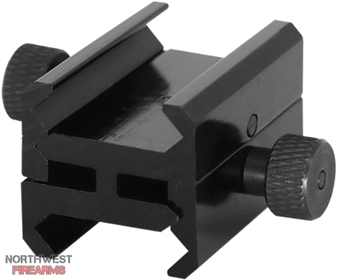

I had this idea of mounting an AR15 with 22lr conversion kit to the bottom rail of a longer AR15, using a couple of these pieces:
One side of these mounts would attach to the bottom rail on the main firearm and then the other side would attach to the picatinny rail on upper receiver of secondary firearm. The pistol grip of the secondary firearm would act as a forward vertical grip for the main firearm. The secondary firearm would have no buffer tube installed.

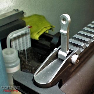

Integral rear flip-up sight. Springs and followers (2) in bored holes under the rail slots. Roller detent in broached recess under last rail. Windage adjusts with standard front post elevation tool. Torq patch on windage screw threads + wave washers. First finish didn't hold up well, so it's back to raw.
Is elevation all done with front sight?
