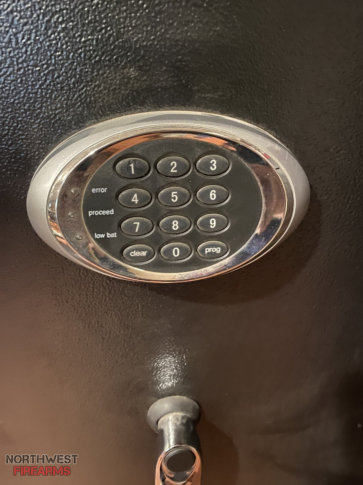

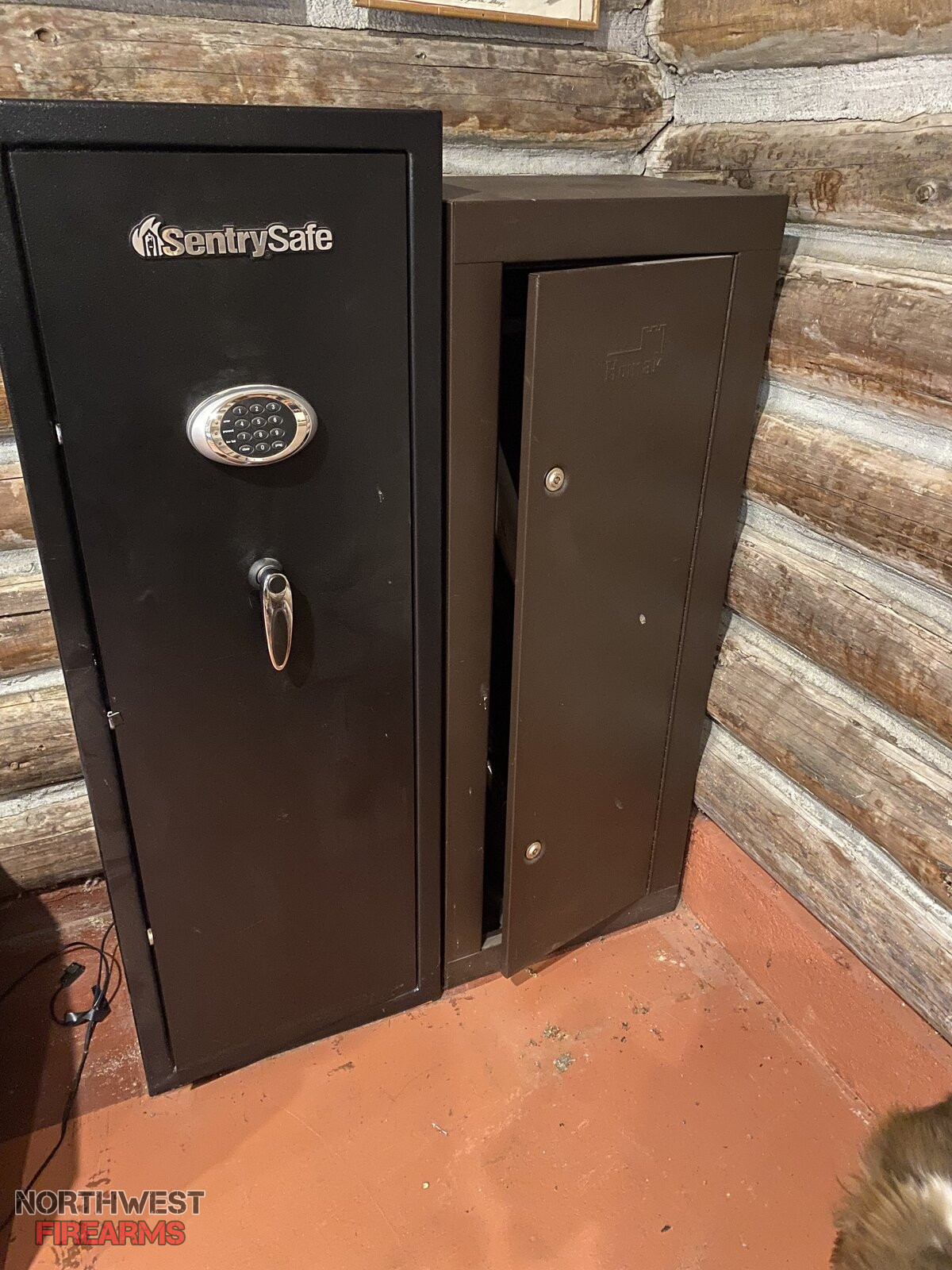

IMG_0790.jpeg Does anyone have a Sentry safe that looks like this? I need a manual with instructions to reset the combination. I have tried YouTubes for similar locks but they don't work. I have the safe open . I just need to reprogram a new code. IMG_0788.jpeg

I will give that a try. I think the # is what I am missing. It acted like it accepted my code change. But then nothing happens. But I am unfamiliar with safe operations .
You only press the * button when reprogramming the keypad and then the # button after you enter your new secrete code numbers when you're opening the safe
When I go to that Sentry web sight, it does not recognize my model number. And my key pad does not have a pound key or star key. I am pretty sure I have been able to program a new, code, I don' y know how the lock is supposed to work.
