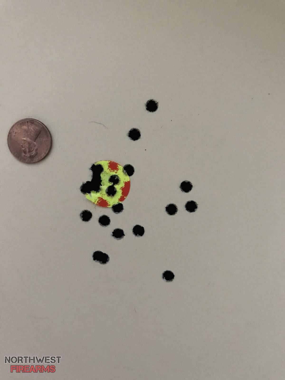

I had a bunch of 62 grain SS 109's. Took them to break in the barrel.

Ss109s and sight in.

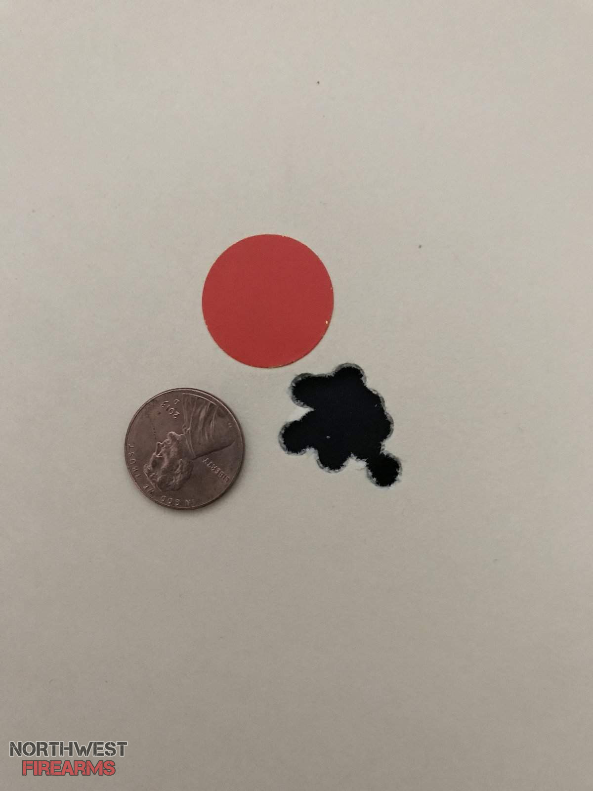

First ladder

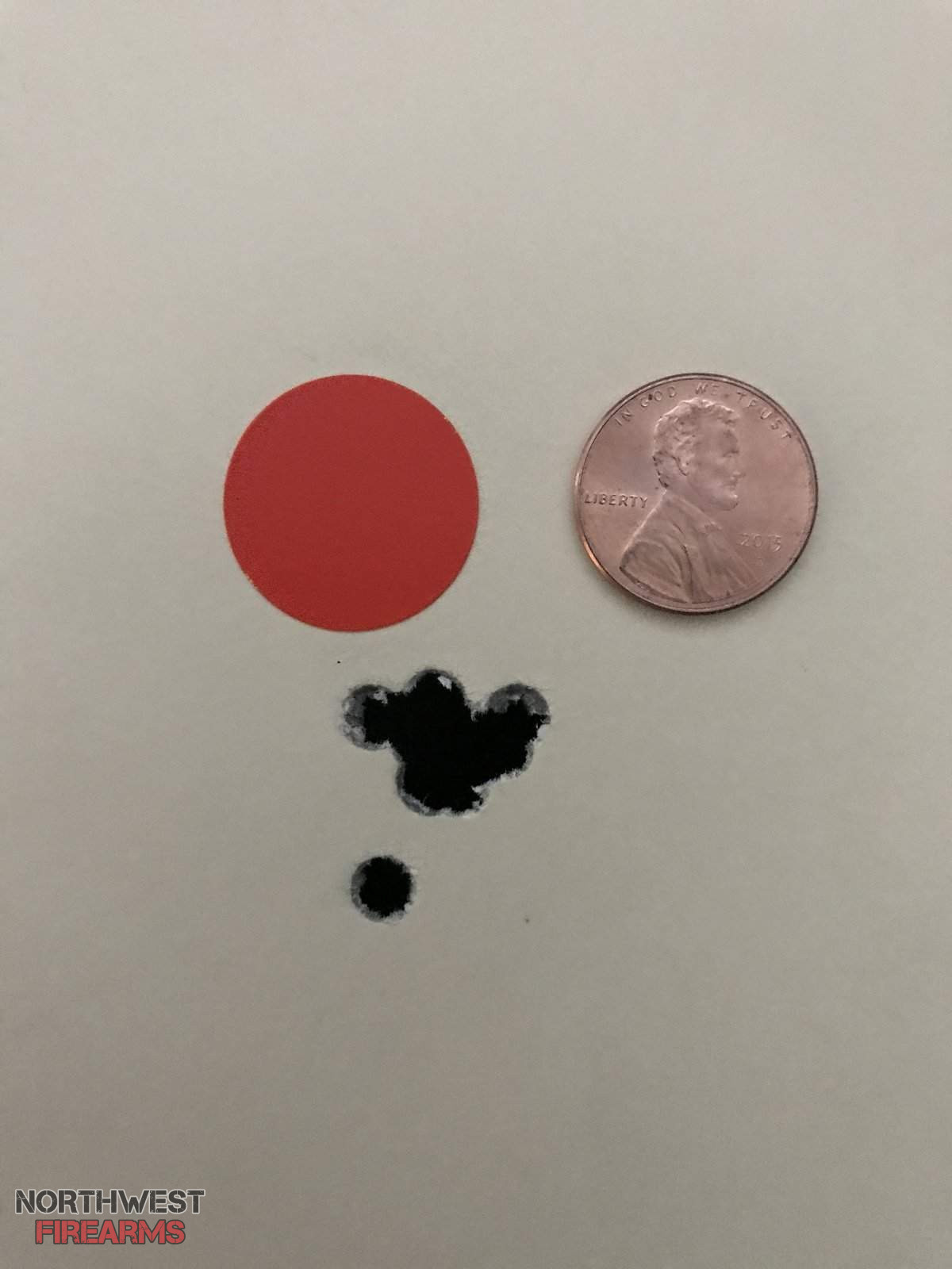

Second ladder
Those are both 10 shot groups.
I pulled one shot second time round.
I am rather amazed that a full grain powder difference didn't effect point of impact more.
I think I found my load but going to check at 300 and see.
