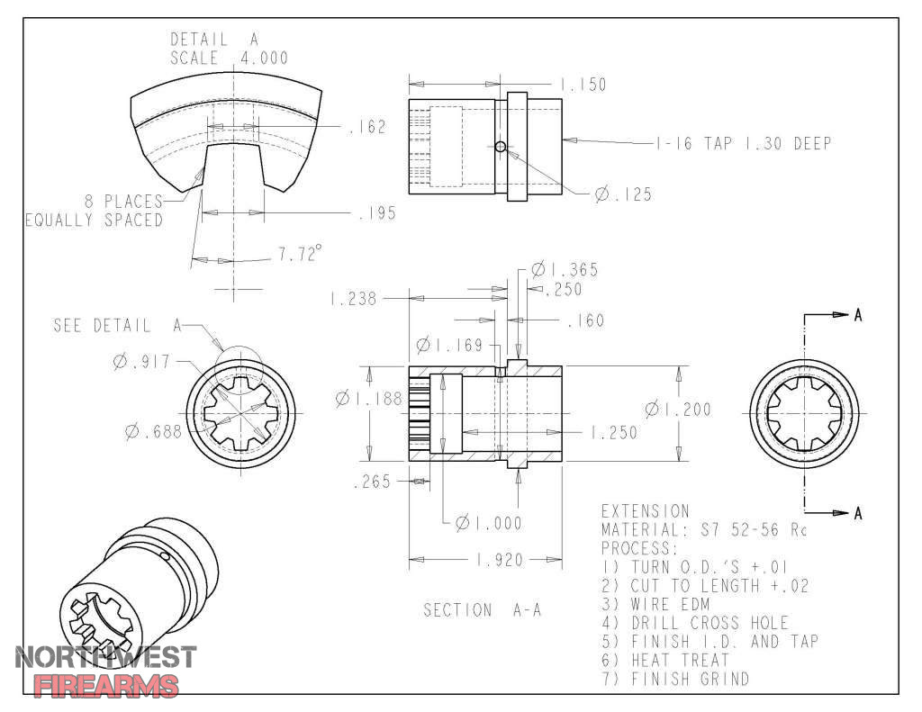

How do you "headspace everyone"? Are you headspacing or confirming headspace? Headspacing an AR is a product of barrel manufacturers not assemblers. If the manufacturer has done a proper job than headspace is not an issue.
First off, because of the design there shouldn't be a head space issue.
I have not read the rest of the posting but I would like to clarify this statement I made. By design the bolt locks into the barrel and if they are properly machined then you should not be having a head space issue. Clearly, whoever built your upper did a really lousy job.
I have not read the rest of the posting but I would like to clarify this statement I made. By design the bolt locks into the barrel extension and if they are properly machined then you should not be having a head space issue. Clearly, whoever built your upper did a really lousy job.

heres the barrel extension measurements.
