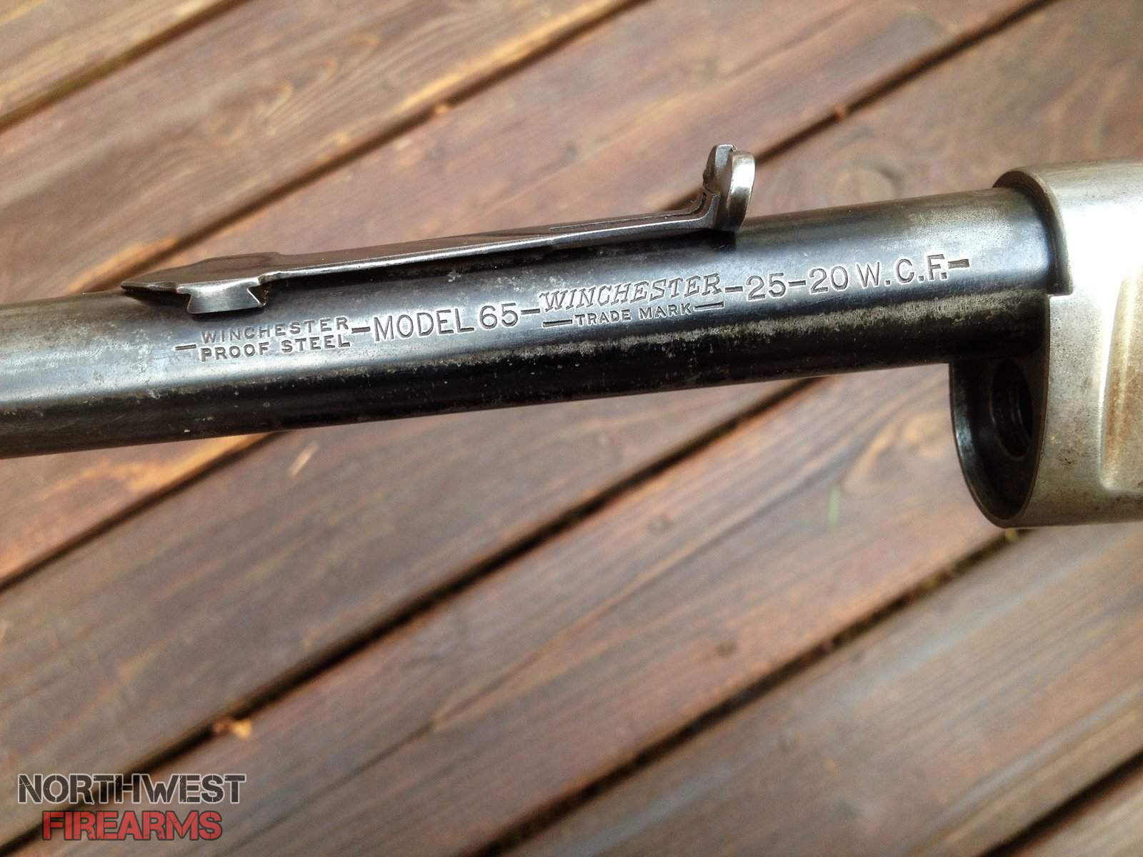

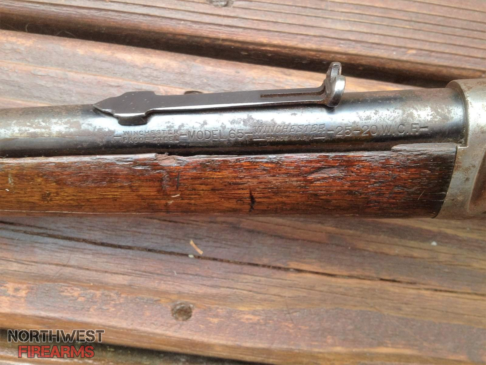

Before and after.
Took 5 minutes. And dose not remove any blueing.
My own prosses.
