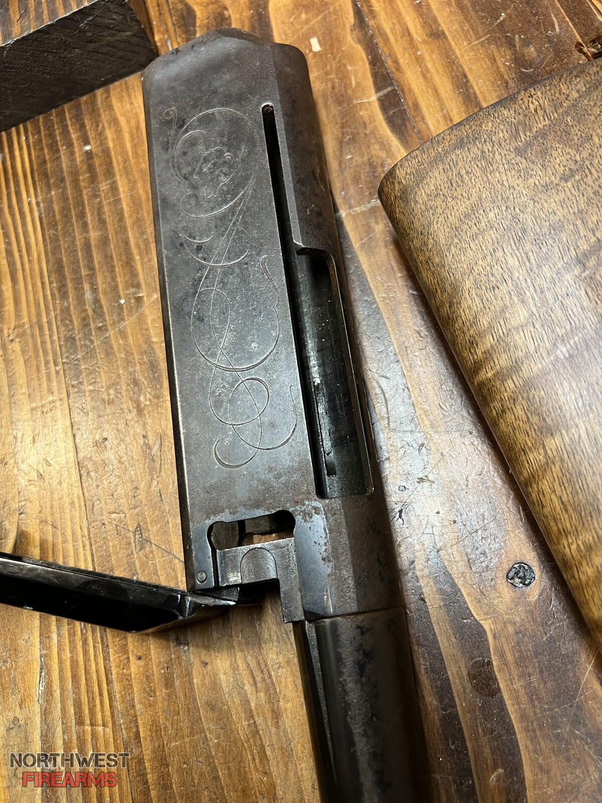

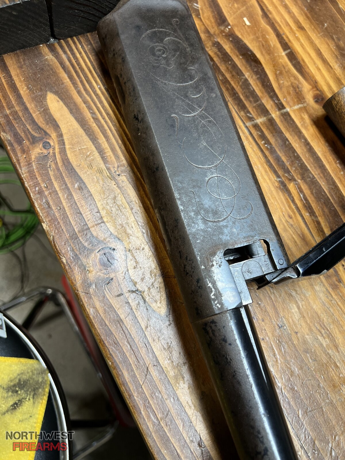

My late grandfather gifted me this rifle years ago. He has recently passed on so I decided to restore it. He kept it on a boat exposed to salt air for many years. I'm looking for the best way to strip everything off to give me fresh steel. I'm thinking I might ceracoat it instead of blueing.

Watch a bunch of Mark Novak "anvil" videos on YT he covers this pretty thoroughly. In several videos but has some videos specifically for this type of deal. Even if you cerakote it the pits will remain. Especially I'm the sand blasting step, sand blasting actually makes pits bigger so be forewarned cerakote is great stuff but I'd DEFINITELY sand blast a little on the lighter side to minimize the pitting.

No matter what you do the pits will remain unless a lot of metal is removed. A good gun shop that does blueing and other coatings might be a good place to start. if there is enough metal remaining you may even be able to recover some of the engraving. If not after the rust is cleaned up go with a flat base coating that does not show gloss or glare. Chemical rust removers work OK. Check out Project Farm on you tube, that guy is good.

Yeah the pits are too bad but I think I'm just gonna paint over them and call it good. The bore is pretty gross so it will never be a great shooter so I don't want to sink too much money into it. Just preventing further damage
Boil or steam the rusty parts for at least 15 minutes, then rub with degreased 0000 steel wool. This is how slow rust blue is done - the steam converts red rust to black oxide. This will make the rust go away with the least amount of pitting. Evaluate after that.

I have to say though. It really doesn't look all that terrible for having been exposed to salt air for many years. He must have taken relative measures and care at some point and time.
Durafil might also be a good option for filling pits and provide a smooth surface for cerakoting.

Soft solder will work well as a filler for paint it is was also used to secure vent ribs on shotgun barrels some time back. No Idea what they do today?
It does, yes! Something like durafill is just incredibly easier to apply and finish when you have large surface areas to deal with.
A few spots here and there, solder is much cheaper and perfectly suitable.
