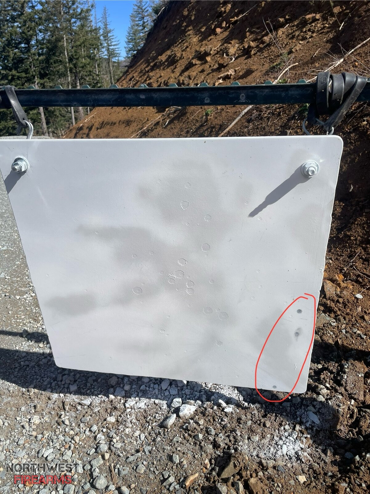

I have 20MOA rings on top of that 30MOA rail, and the turret is almost maxed out "backwards" to zero at 50 yards. Like ORhutner I max out all of the elevation I gained back (73MOA for me) and hold over the rest in my reticle to send a subsonic 40 grain projectile as far as I possibly can. My farthest recorded group was about 10" at 509 yards
