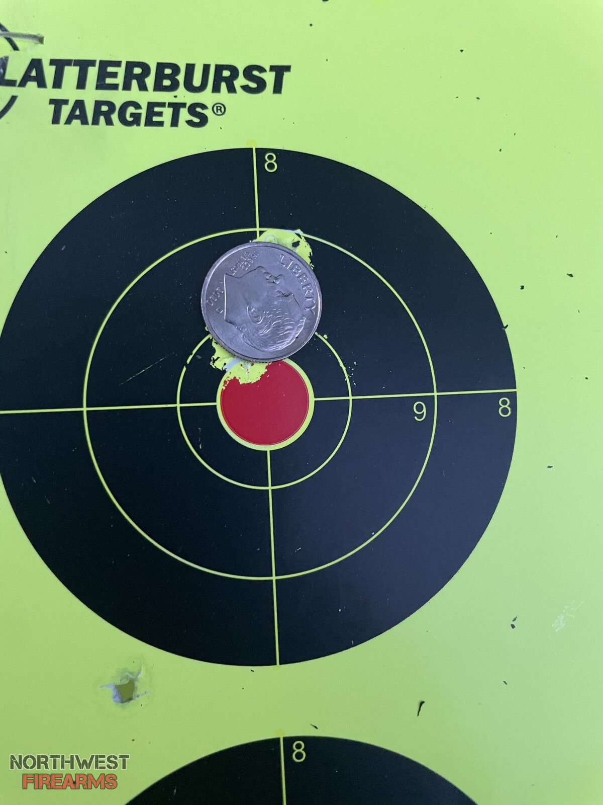

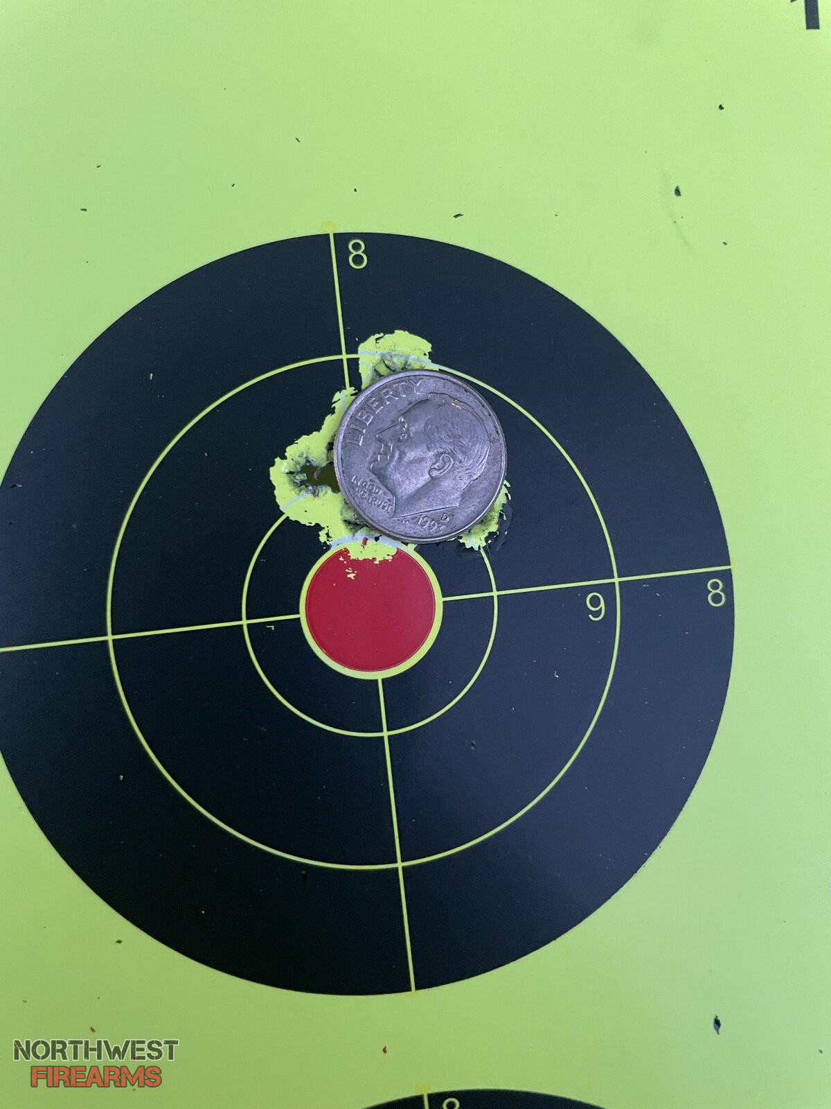

Here's what it did with the 30mm Vortex scope that has fat crosshairs at 70 yards. My 13 year old son shot the one on the left. I have a super fine crosshair scope that I think I can improve these groups with as the Vortex completely covered the bullets. Thats when I found out what that 30 moa meant in the rail.
