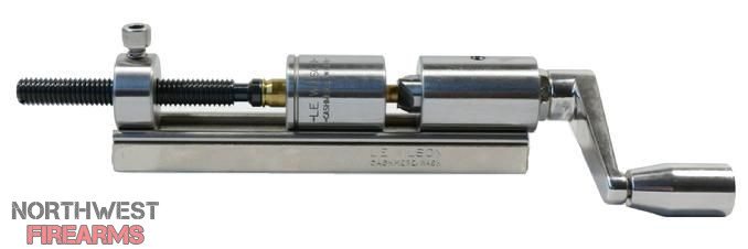

And a Wilson case trimmer.
Me; a consistent trimmer. I've been getting by with the Lee gauge and cutter combos and a cordless drill, but the gauge doesn't stay the same length over time. My rifle brass isn't exactly the same every time. Probably get this RCBS Trimmer.
The Wilson may be "over the top" for some shooters but there isn't a finer case trimmer made.
It holds the case in a much different way. It is built like a miniature lathe.
I bought mine when they were half the cost of what they are now.
