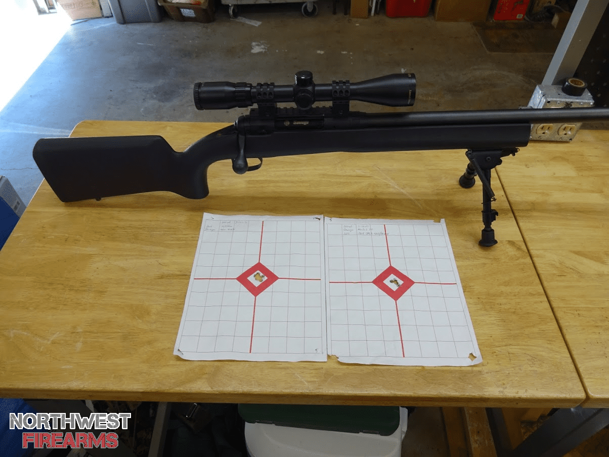

Good choice of powder and bullet. I have reloaded 308 for many years. IMR 4064 is my favorite powder.
I would choose 168 SMK for shooting out to 300 yards. 175 SMK for over 300 yards. I think your loads are
at the upper end may be too high PSI. My load for 168 SMK is 41 grains. Are your Federal cases properly sized?
I assume you are using a full length sizing die as you should. Chamber the resized brass in your rifle. The bolt should
close with normal pressure. And easily withdraw the sized case. If not your case is not sized correctly.
Adjust the sizer die to bring down the case shoulder. Don't worry about run out now. See how it shoots.
The Federal brass is soft good for only a couple reloads. Loose primer pockets after a couple reloads.
308 Savage with 168 SMK and IMR 4064. 5 shaots @ 100 yards
