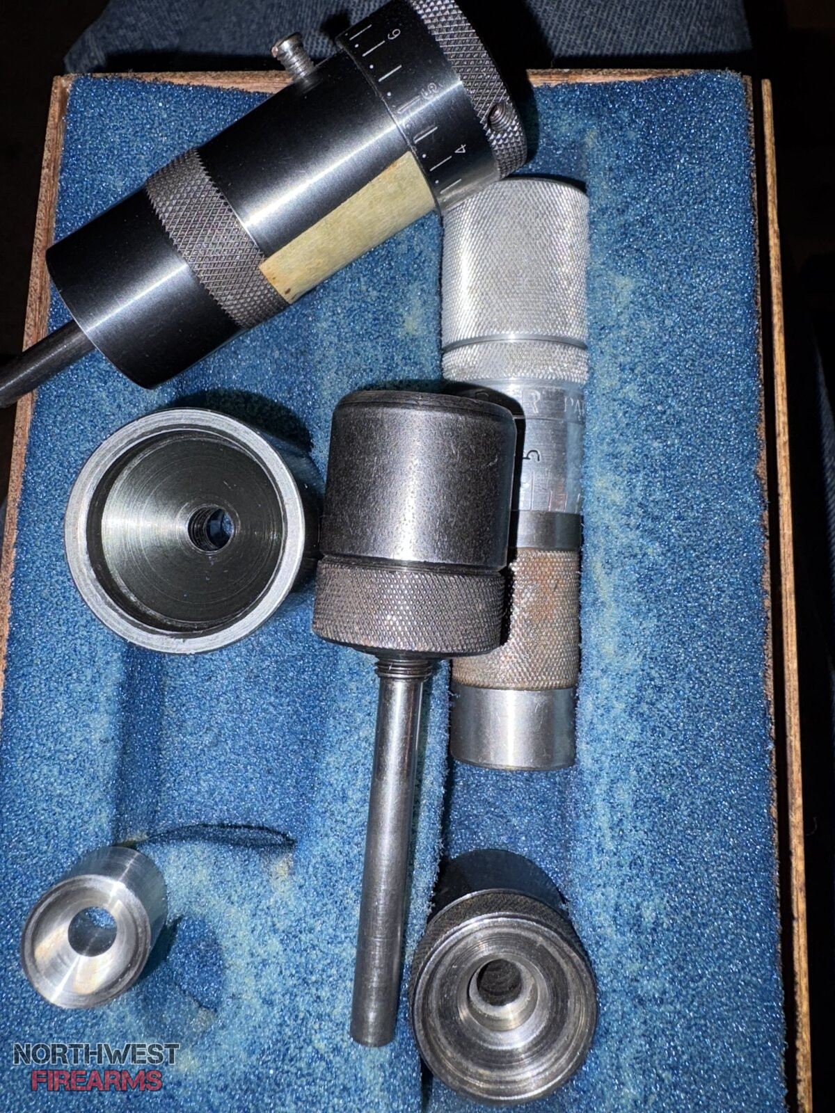

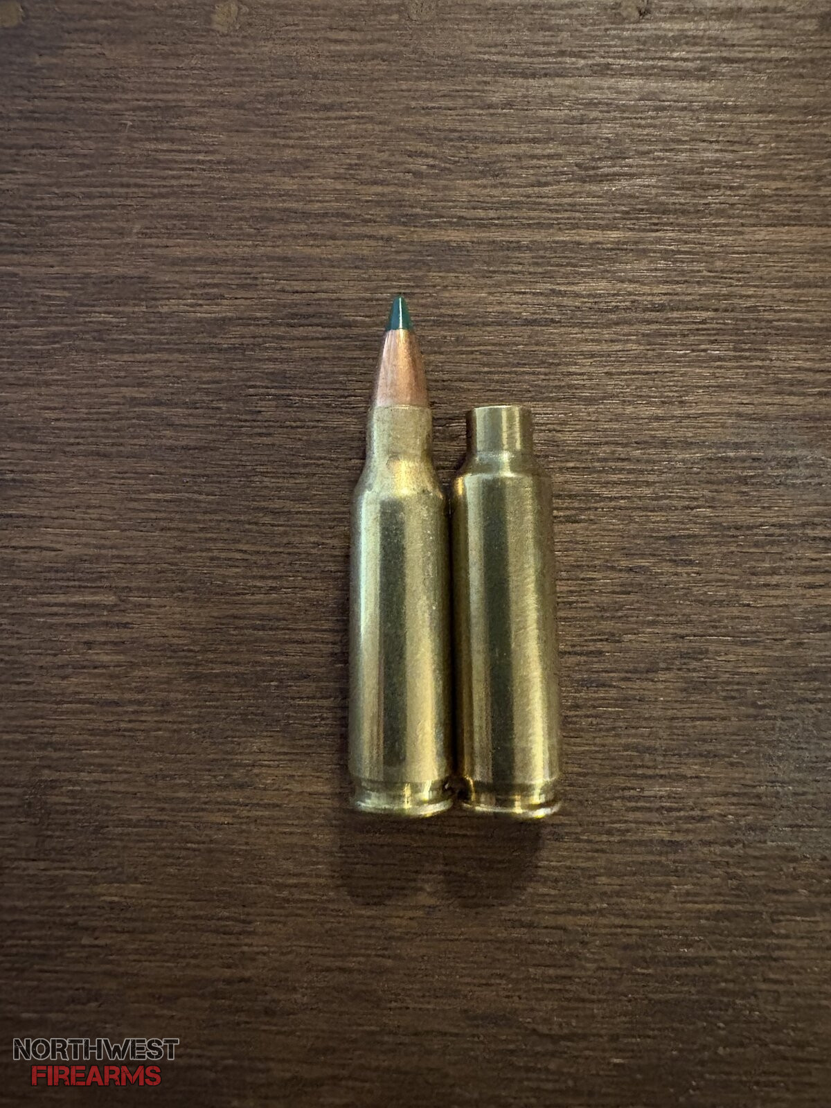

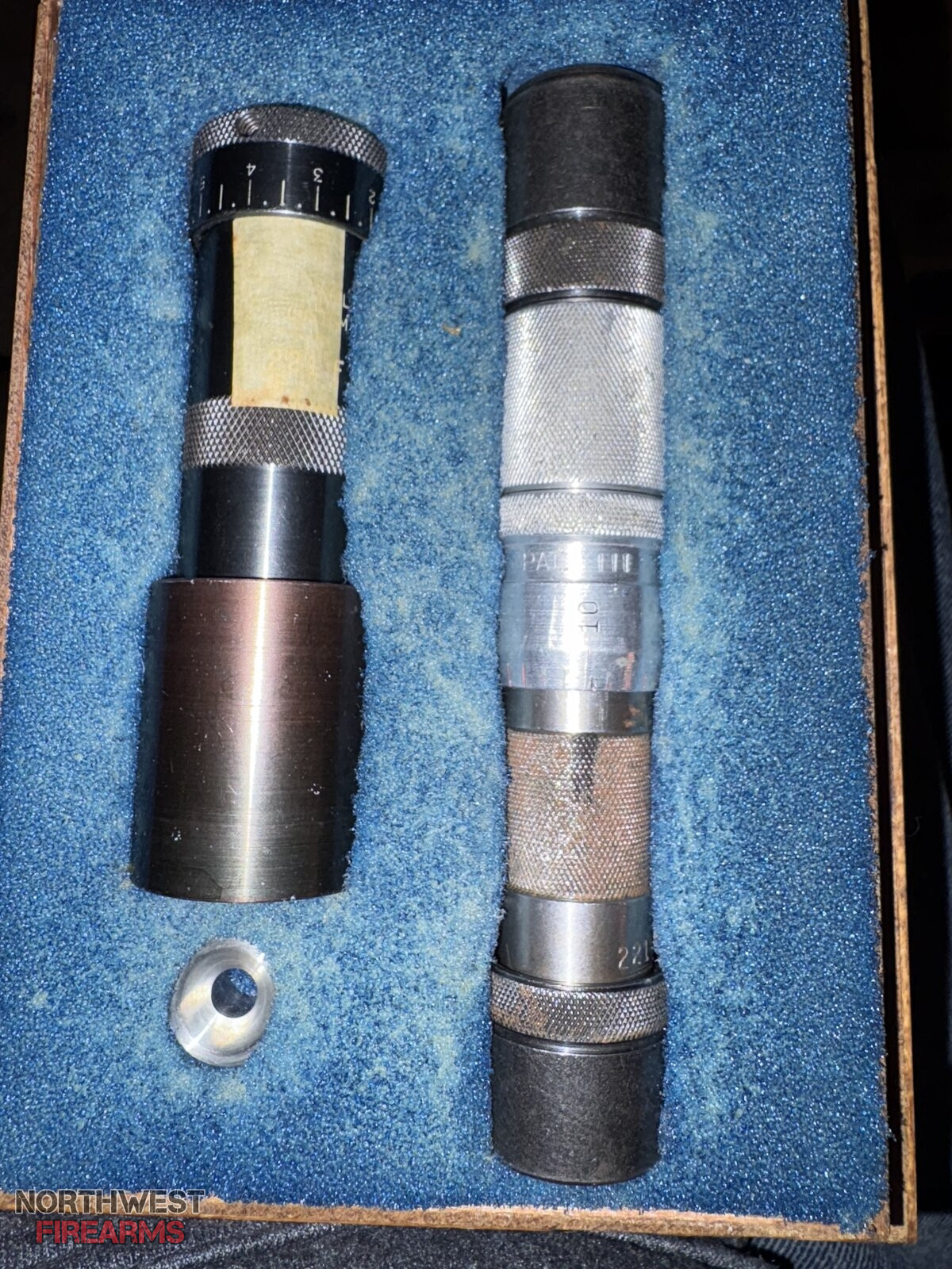

I bought an older custom rifle in a wildcat chambering. It came with everything to load but I'm not familiar with these dies. They are built by Neil Jones Precision. I believe I need to use an arbor press as there aren't any outside threads. I had been following this rifle around local gun shows for several years but one time it caught my eye. When I saw what the package deal included I bought it. Three years later, I finally have time to shoot the thing but being a wildcat cartridge I need to learn these dies. It came with a lot of brass, parent case is the 221 REM Fireball but brass can and has been converted from 223/556. It came with lots of targets showing the accuracy, looks like a .25MOA or better rifle. The rifle has a Canjar trigger as well, found out these are about as good as one can for a Remington action. Ok, story out of the way, question is-how do I use this die set? The bullet seating die I have figured out but the sizing die has left me scratching my head. Here's some pics of them and a fired case next to a factory Fireball case. Any help here is greatly appreciated!

Looks like a neck size die only and have you checked out their website? https://neiljonescustomproducts.com/
Yes, sent email but being the weekend now I got impatient, LOL. Also, the internet has conflicting reports of whether he is even still making them or alive. I have a reamer and looking at info right now if I can use that to cut a readily available die blank. A full length and neck sizing die would be great to have. There's companies who will take some fired cases and make a die set for about $400. I can swing the $$$ but they have at least a 24 month lead on custom products.
Measuring the reamer and fired brass I have I'm looking at my Lyman reloading book and devising a plan with other dies from different chambering. It has the same taper and body dimensions as a 7mm TCU and some others. I'll just have to size the necks with a 22cal neck sizer I already have. It ads an extra step but I can start shooting right away.
That looks like a die set designed to be used on a handpress, and a big one to boot. You could probably get away with a hand pump hydraulic press from harbor freight, but that would probably double the time per round. Most of the cheaper handpress you can find online only have a 6 inch throw, and that looks closer to 8 inches. The other question is pressure. Hand presses can be pretty difficult to fully resize a case, let alone reform it. Just the neck is fine, but anything past that gets much more difficult fast. You may want to opt for a flypress if that reforms a good chunk of the case. Use lots of lube.

After looking at a lot of options I may just get a die set from another cartridge that matches the diameter and body taper (7mm TCU fits the bill) and size body and neck separately. It'll work until I decide to fork over $400-$500 for a set of custom dies.

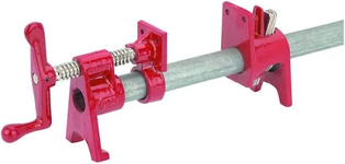

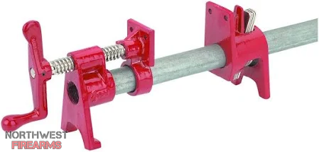

Just to try out your dies, use a pipe clamp or a drill press.

First off, do you know the name of the wildcat? Hard to tell from pictures but it looks like a 221FB AI (Ackley Improved)
40 degree shoulder?

So, I'm getting the hang of these inline dies. Once I picked up an arbor press it made more sense. I've loaded close to 100 rounds developing some loads to hone in on. My best so far at 50 yards off of a bench measures .125" center to center. This is with a five shot group, not a three shot group all you cheaters are using :p. I'm hoping the weather holds out tomorrow so I can stretch it a bit further. I've been really impressed with this custom cartridge rifle I recently starting shooting. Some old timer sure did love this thing and spent a ton of time and $$$ developing this cartridge based on the 221 Fireball.
