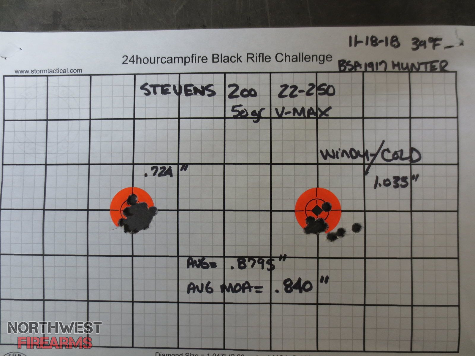

Too bad you are set on Redding. Not to dis on them, but all I use is RCBS and accuracy is not bad at all.. Won a few + turkey with a few of my rifles and handloads recently....:
This is a load I worked up with my newest rifle. Not a heavy barrel either:

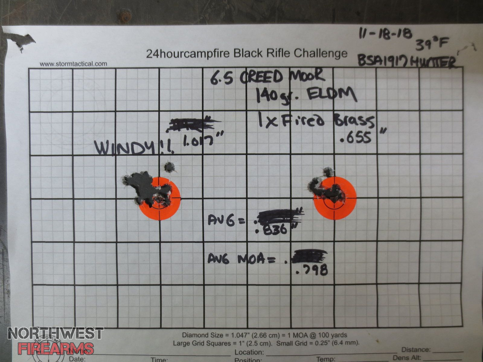

The 6.5 CM I was talking about:
Regular ol RCBS FL sizing and seater set you can buy at bi-mart or just about any place that sells reloading equipment..
Wow, very nice shooting! And even with the wind, both averages come in under MOA - you must be extremely pleased with that performance!
