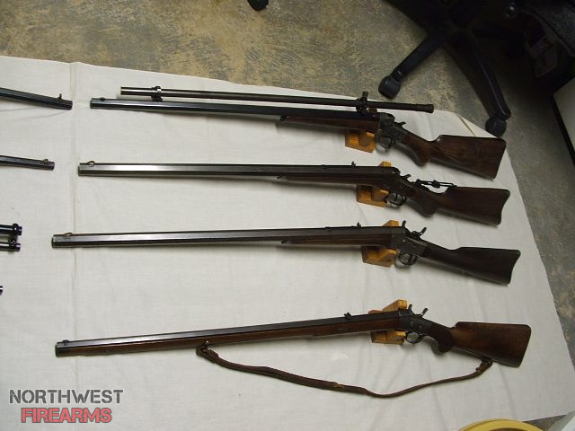

Found my thumb drive, but no pictures of the Hepburn prior to and just after having the barrel original work done. I did locate this "group" picture from our local OAC gun show that contains the Hepburn.
It's the 2nd Hepburn down from the top in this image. It was/is a very nice gun, with just a crappy barrel repair.
