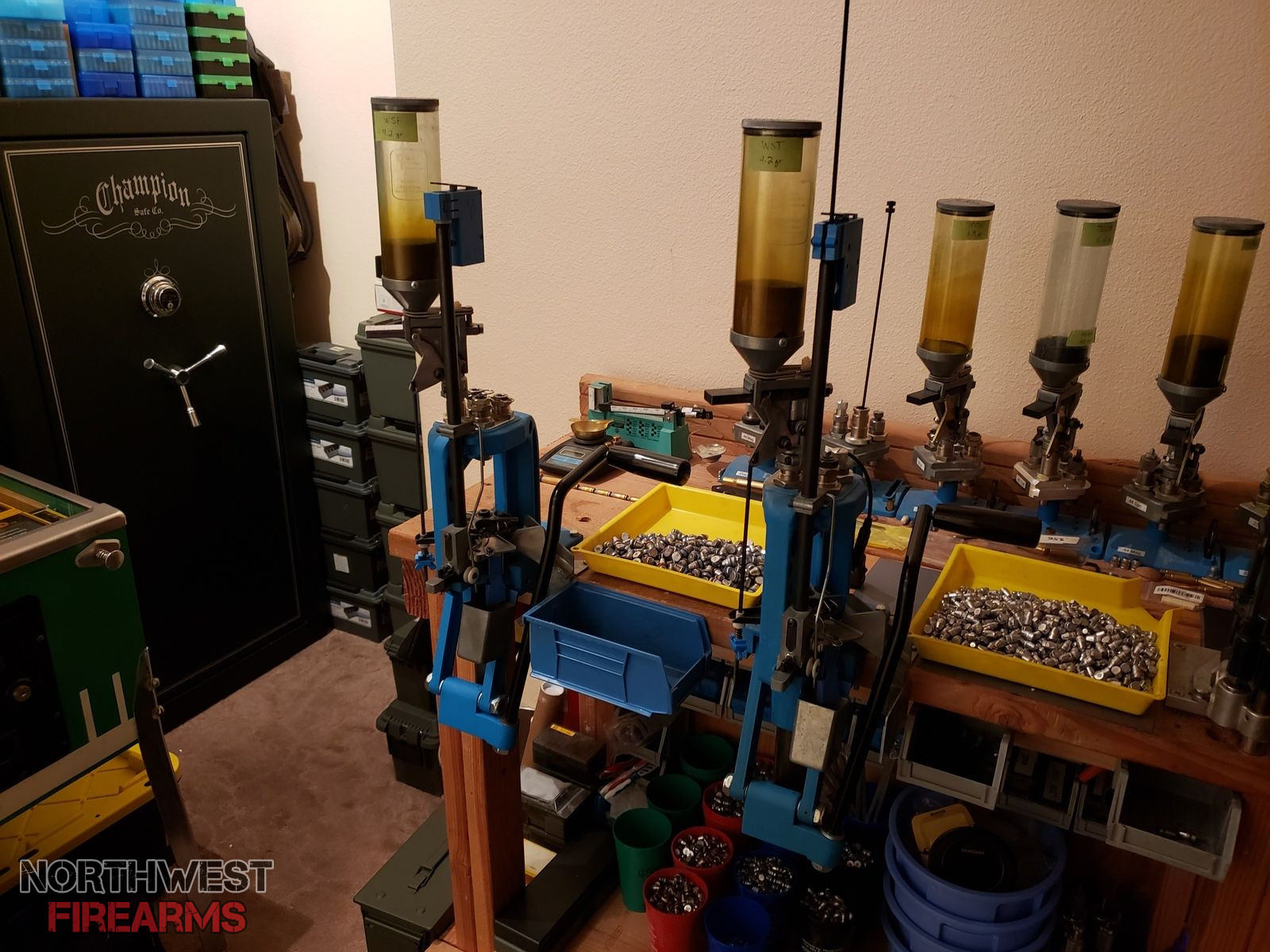

Changing primer size? My easy solution...
My setup/solution looks very similar but I don't have as many extra tool heads.
