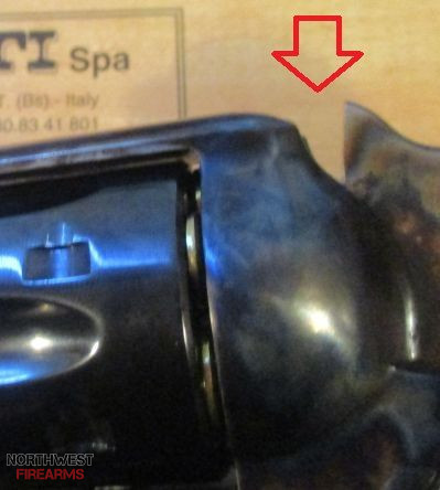

So, I picked up a brand new, Cimarron Lightning from the FFL on Thursday. It is a single-action, chambered in .38 Special.
I just now brought it up to the home range for some shooting. I loaded six rounds of 130-grain, Winchester-brand, .38 Special. I cocked the hammer, fired, and when I tried to cock it again found the cylinder completely immobilized. The hammer won't go back more than a few millimeters. I tried removing the cylinder by depressing the base pin screw and sliding the pin out, but it got stuck half way. Now it can't be pushed back in or pulled all the way out.
Does anyone know what I can do to at least get the live rounds out of this revolver so that it can be returned for repair? There is no way, legally or ethically, I can ship it back in this condition. I hesitate to bring it into my gunsmith with live cartridges either, though he is a good guy to work with, and might understand.
I have a message into Cimarron, but I doubt I'll hear anything until Monday. Thanks all.
How far the hammer will go back:
Stuck pin:

Thanks for the notes. It appears to be a negative on both. I shown a bore light down and I see an empty cartridge case and no bullet. The other five rounds don't appear to be locking it up.

Thanks all for the replies and thoughts. Additional details, in case it helps:
  • The hammer is decocked. I can only pull it slightly back and it never even gets to the ¼ way mark.
  • As far as I can see, there is no bullet that "jumped" and jammed it up.
  • A high primer may be the case, but I am not sure how to tell.
  • Good point on the pin being the "sticking point", no pun intended.
  • The cylinder only wiggles just a tad, either with or without the trigger pulled.
  • Pulling the hammer back does make the pawl lower far enough to be disengaged, but I still can't rotate the cylinder by hand.
  • Not sure about how to check the cylinder hand though that does sound like the symptoms here.
  • Agreed with the comment in post #8. Not real impressed with Cimarron thus far. Though, as noted, it could be an ammo-related fluke.
Thanks all. I really appreciate the ideas and thoughts. :)
Mark, you are the man with the plan! I got the cartridges out. :)
Basically, he had me hold the hammer back and slightly wiggle the cylinder back and forth, back and forth, over and over again and, son of gun, it popped free. I now have the five loaded cartridges and the spend casing out of the gun. The pin is still stuck and I'm working on that next.
