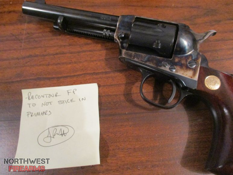

I hear you. I am the same way; if a piece of equipment is not working, I can't help but fix it. That said, since this thing literally failed on shot number one, it is going back to the manufacturer. I'm going to give Cimarron a ring tomorrow and UPS it back. If it is of interest, I'll report what they find.

Minor update on this ...
The Good: It is covered by their warranty completely. As it was bought less than 30-days ago, they pay for shipping both directions, which is a nice policy. (I don't remember many manufacturers I've dealt with doing that for new, but non-working gun.)
The Bad: It has taken lots of back and forth since Monday to get an RMA and a return label out of them. For the life of me, I don't know why this was so difficult for them.
The Ugly: The UPS hub is an hour round trip from here. I head up this afternoon and find they absolutely, positively, refuse to take the package. Why? The label says "2nd Day Air" not "Next Day Air". So, back to dealing with Cimarron. Or if they aren't helpful, I'll just next day air on my own dime as I have the RMA and all the other information.
Anywho, it will be interesting to see what the find once it actually gets back.
Just an update on this. I received the revolver back today. The note contained with it reads "— Recontour FP to not stick in primers".
Bizarrely it took longer (close to two weeks) to get a RMA and return label that would work with UPS than it was to get it fixed and returned. Depending on the weather and other factors, I might give it a test shoot tomorrow.

I went up to the home range this morning and shot up about half a box of cartridges. There were no issues of any kind, so it appears to be fixed. Thanks again to those who replied on this troubleshooting thread. :)
