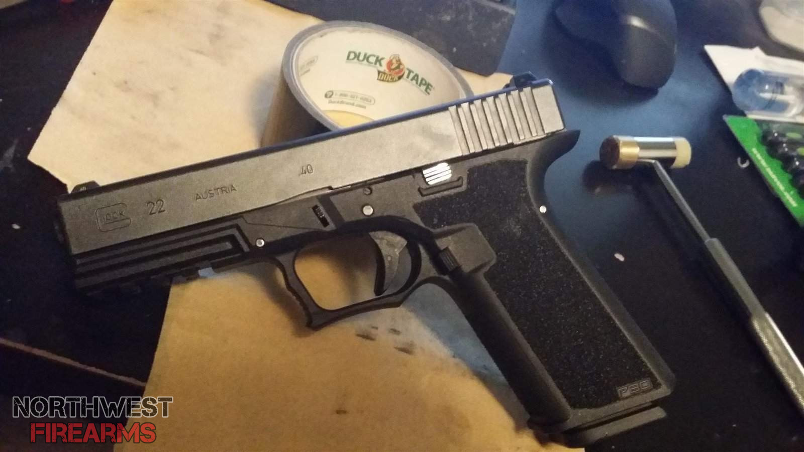

I had a lot of fun building mine. I've never done anything like that before. I went with with the full size as I already have compacts and I won't be carrying this.
I used police trade in G22 parts. I used police trade in magazines. All of which I got for big discounts. By building a G22 you can ofc shoot .40 cal but also grab a 9mm and .357 sig barrel and have 3 cals to shoot. Just need 9mm mags.

I suggest watching a bunch of youtube vids before starting.
The number 1 reason it won't run smooth is the barrel seat area needs to be smoother. This should have no "lip" anymore and be wet sanded with WD40.
Polish the rails with some good aluminum polish. Be ready to sand the rails for a perfect fit with the slide.

Frame from Brownells for $105 shipped on sale, couldn't resist the price and it's what started me down this path.
The lower parts I also got from Brownells. I'm using a few used parts from the kit but I got a new trigger/bar/housing from brownells just to help eliminate failure points with the used glock parts. Probably wasn't needed.

Sorry, one more question. Did you install the .40 extractor? I know it will also work with 9mm when using a conversion barrel. Was just curious.
My bad, I meant ejector - the part in the lower. They are slightly different in Glocks for 9mm and .40
The sharp metal thing in the lower... roger! It's still the .40 cal.
From what I've read its hit or miss if a .40 cal will run smooth with a 9mm barrel with just the barrel change or yeah you may need to change out the ejector and I've even heard of some people needing to change recoil springs also.
I've run 9mm conversion barrels in .40 Glocks (22, 23 and 35) with no problems. Never changed the ejector or recoil spring. Just the barrel and magazine and it's good to go.
