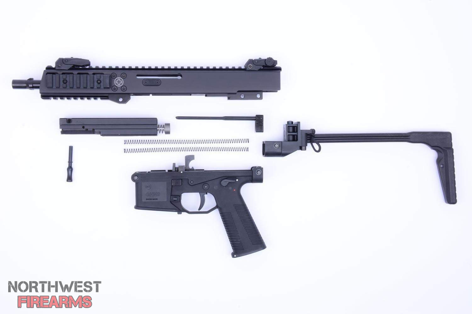

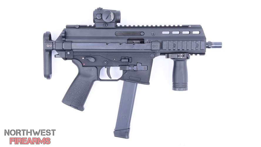

If you were to go with a non delayed blowback. I'd recommend the B&T Series of 9mms. They have a hydraulic buffer inside that essentially absorbs the momentum of the bolt and never allows it to fully travel rearward.
